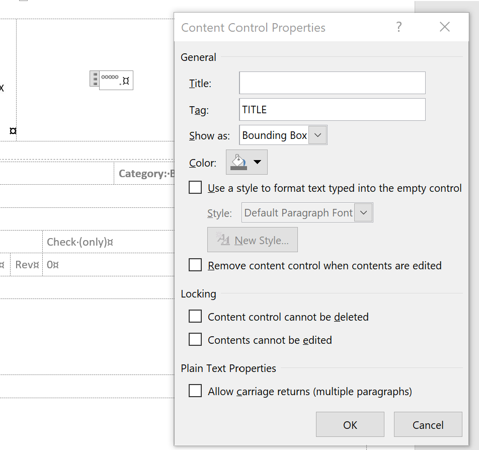

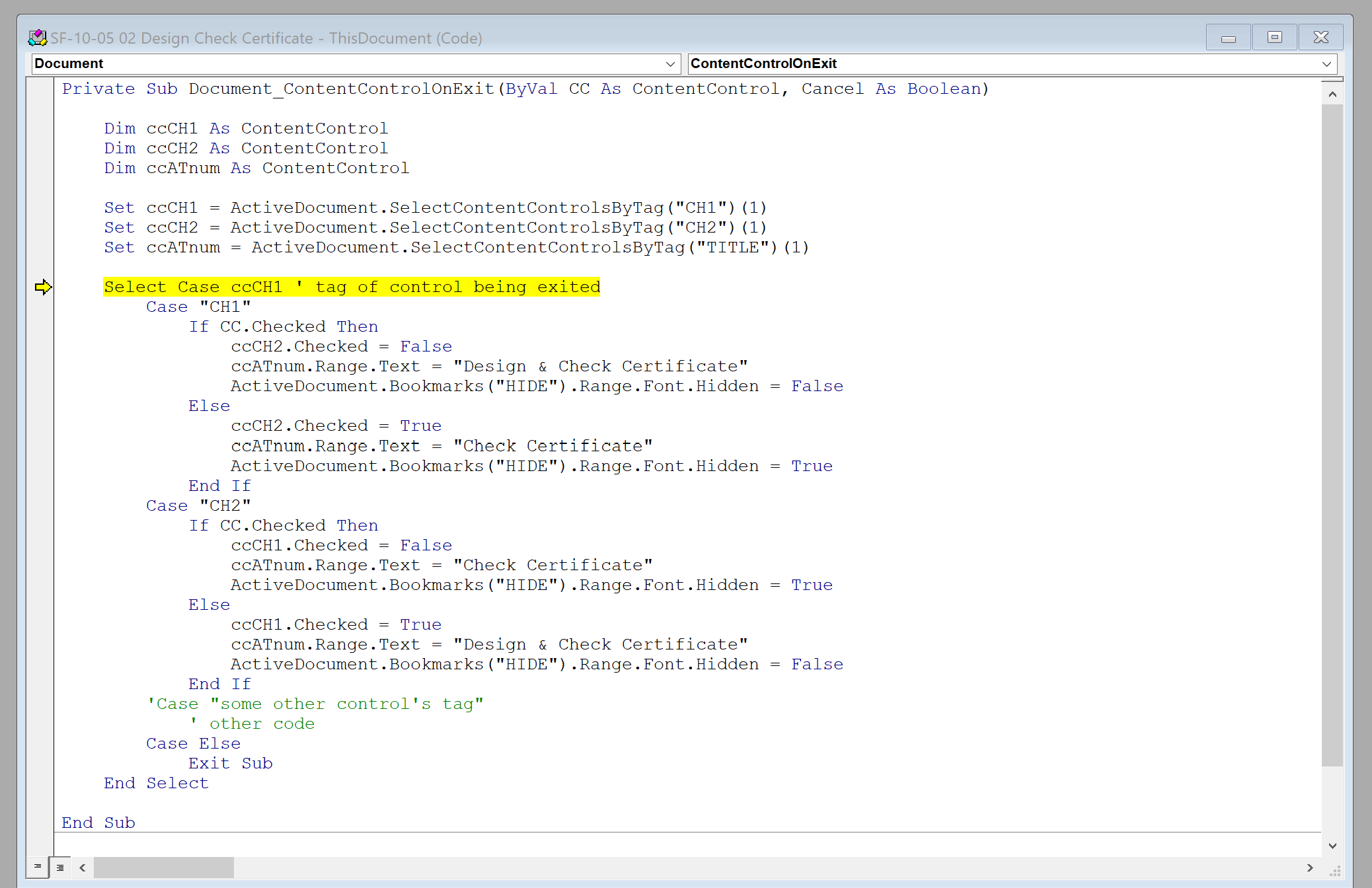

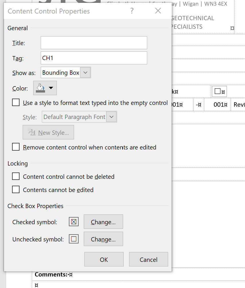

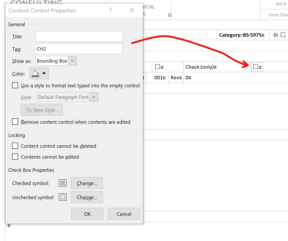

    Hi Jay
    Thanks.  I have made the changes (I think) but still not working.  If I understand your comment regarding autotext, basically there's no need for it as I just type the actual text I want to appear directly in the VB code a shown below.  Is this correct?
    See other screen grabs for changes made

  4. Jay Freedman 206K Reputation points Volunteer Moderator
    2020-05-05T21:38:31+00:00
    That's exactly what's supposed to happen when the bolded lines execute:
        Select Case CC.Tag ' tag of control being exited
            Case "CH1"
                If CC.Checked Then
                    ccCH2.Checked = False
                    ccATnum.Range.Text = "AT1"
                    ActiveDocument.Bookmarks("HIDE").Range.Font.Hidden = False
                Else
                    ccCH2.Checked = True
                    ccATnum.Range.Text = "AT2"
                    ActiveDocument.Bookmarks("HIDE").Range.Font.Hidden = True
                End If
            Case "CH2"
                If CC.Checked Then
                    ccCH1.Checked = False
                Else
                    ccCH1.Checked = True
                End If
            'Case "some other control's tag"
                ' other code
            Case Else
                Exit Sub
        End Select
    What may be confusing is that this doesn't happen until the cursor exits the content control (because this is in Document_ContentControlOnExit, which gets started when the cursor is about to exit). So when you click the check box, but before you hit the Tab key or click another control, you'll see either both boxes checked or both boxes unchecked.
    It is possible to make these check boxes respond immediately instead of waiting for the exit. Greg Maxey has an article at https://gregmaxey.com/word_tip_pages/content_control_custom_events.html that shows how to do it. But this is 400-level wizardry, not really for a novice VBA programmer.

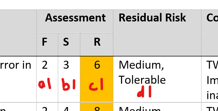

    On a separate issue, is it possible to perform calculations in a Word Table and to automatically calculate the cell value with conditional formatting applied to the calculation cell? e.g. cell c1 = a1 x b2 and conditional formatting applied to c1 were cell is filled green when c1 value < 5, filled orange when c1 value is within range 5 to 9 and filled red when c1 value is >9.  Cell d1 would return 1 of 3 standard text items depending on the value of cell c1.
    I appreciate this is standard stuff in Excel (of which I already have a working form) but would prefer to recreate in Word for ease of inputting text, formatting and combining multiple forms into a single working form.
