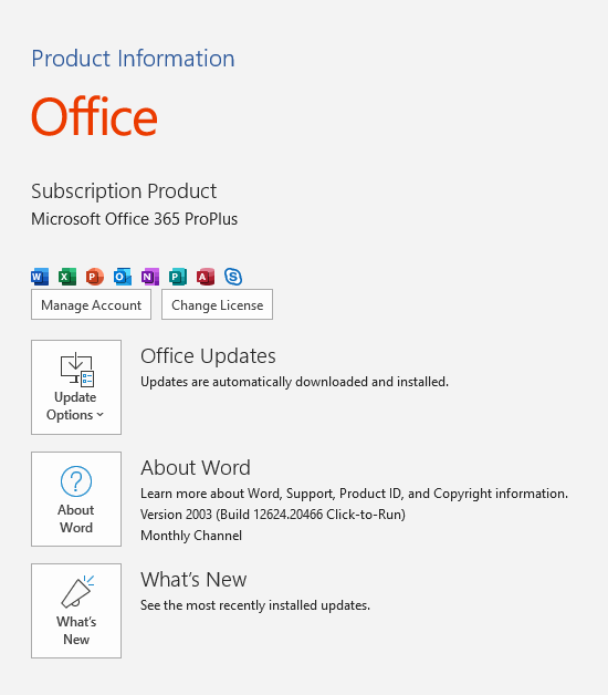

    2020-04-22T19:18:18+00:00
    hi Ivy,
    I tried to open it from SharePoint online and it worked, the file is opening, but when I try to open it again from file explorer it gives the same error.
    This is not only one file, but it also happens to different files in different folders.
    Below are the screenshots.
    Thank you

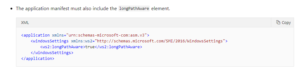

  5. Anonymous
    2020-04-30T18:00:23+00:00
    Thank you so much for the response Ray.
    There is a solution for long path names and this can solve our problems.
    It says in that link that we need to update application manifest. Could you please help me to find where I can find this application manifest xml?
    Thank you
