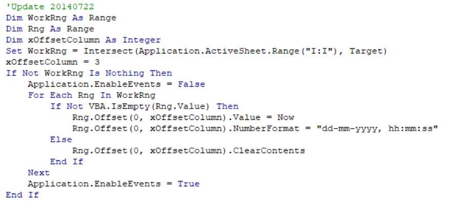

    Please cut/paste the chunk of codes as shown in screenshot below into Notepad.
    I hope it worked out well for you. If not, please reply back to this forum to let me know. I will be glad to follow up and help you.

    2020-08-13T07:26:29+00:00
    Please remove these codes
    2020-08-13T07:28:56+00:00

    2020-08-13T07:30:30+00:00
    Hi David,
    Please see my screenshot above. : )
    Thank you,
    John
  5. Anonymous
    2020-08-13T08:27:54+00:00
    Hello John,
    I tried doing that, but it didnt seem to work and now (this also happened before btw) my excel has been crashing non-stop whenever i try to make the slightest of edits
    is my macro too big or something weird?
