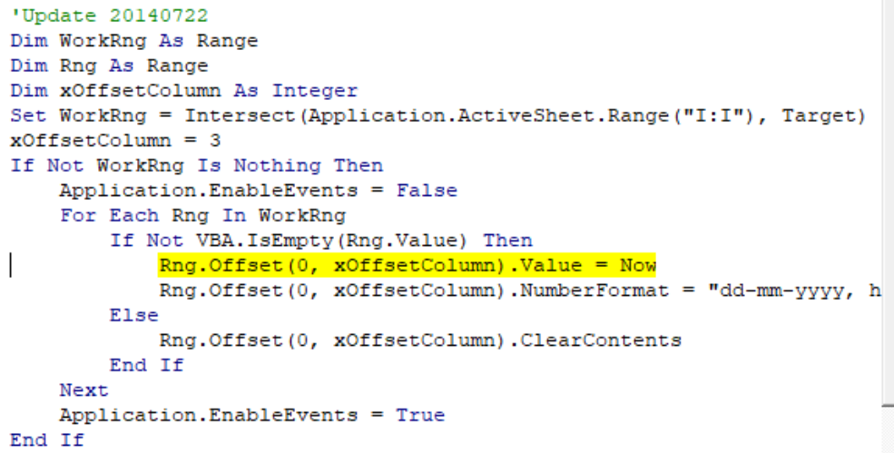

    How do I fix this? It highlights the following:

    Hi David,
    Please remove the chunk of codes as shown on the screenshot below and see if it fixes the issue. I thought you have already removed those.
    Please let me know what will happen.
    Regards,
    John
    2020-08-13T10:47:47+00:00
    Remove all of these codes.
    'Update 20140722
    Dim WorkRng As Range
    Dim Rng As Range
    Dim xOffsetColumn As Integer
    Set WorkRng = Intersect(Application.ActiveSheet.Range("I:I"), Target)
    xOffsetColumn = 3
    If Not WorkRng Is Nothing Then
    Application.EnableEvents = False
    For Each Rng In WorkRng
        If Not VBA.IsEmpty(Rng.Value) Then
            Rng.Offset(0, xOffsetColumn).Value = Now
            Rng.Offset(0, xOffsetColumn).NumberFormat = "dd-mm-yyyy, hh:mm:ss"
        Else
            Rng.Offset(0, xOffsetColumn).ClearContents
        End If
    Next
    Application.EnableEvents = True
    End If
    You do not need those since you have already declared the automatic date above.
    Regards,
    John
