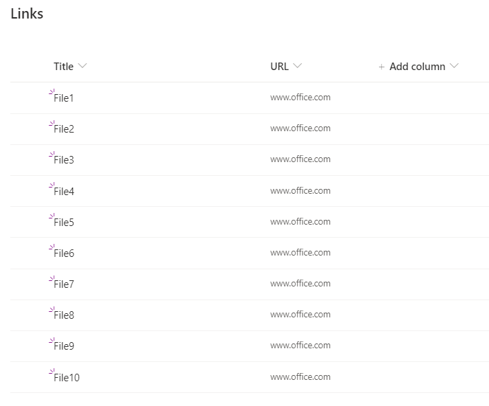

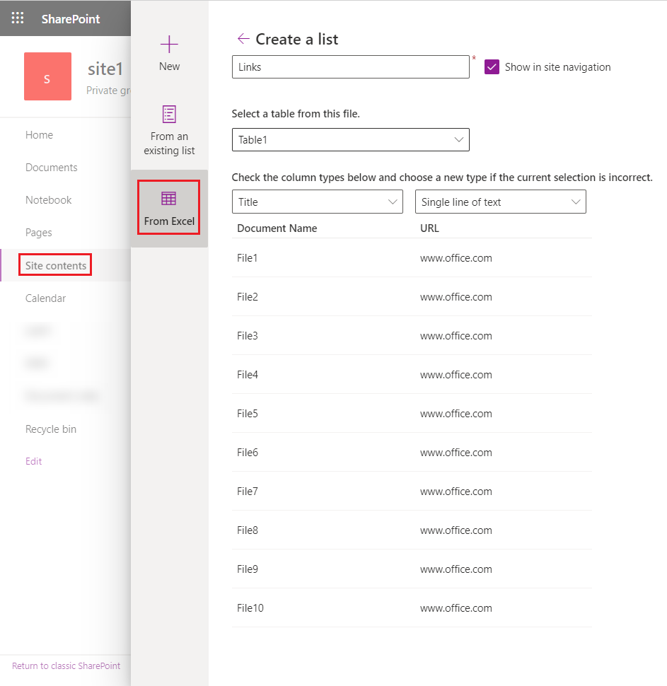

    According to your description, I'd like to suggest you create a new list based on your workbook instead of creating links in the document library, it will import all the items form Excel to the list at one time, here are the steps:
    1.    Make sure you have formatted the data as a table in Excel.
    2.    Go to SharePoint Online site > Site contents > click "+New" > select "List" > From Excel > upload your Excel workbook and import the data.
    However, there is a small flaw that this method can save a lot of time and effort, but the column type of the "URL" cannot be set or modified to "Hyperlink type", which will result in the links cannot be opened directly, you may need to manually copy the link to the address bar to open it.

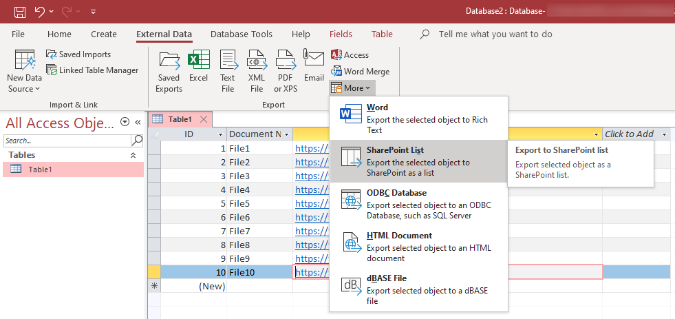

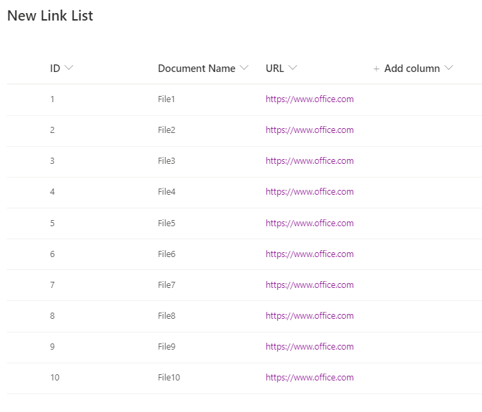

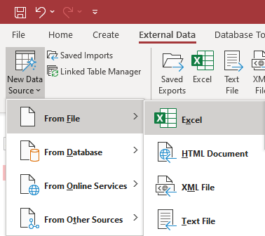

    Thanks for your quick response, after further attempts, I think we may found a perfect solution:
    **1.**Create a table with required columns in Access, please make sure the "URL" column is set as "Hyperlink" type in Access, and please note to prefix the address with "https://"
    2.    Move data from Excel to Access.
    3.    Connect the current Access table to a new SharePoint list.
    4.    Links will be clickable in the new list created by Access.
    Hope it can help, please keep me informed if you encounter any problems.
