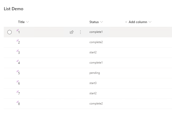

    You need to use ne instead of eq false.  For example, you have the following list with the items below. You want to filter all items excluding pending, column1 and column2 in Status.

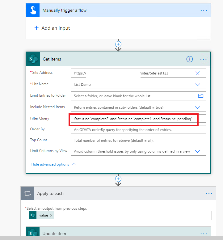

    You can use the following filter query to see the result.
    Status ne 'complete2' and Status ne 'complete1' and Status ne 'pending'

    Thanks Cliff.  I had tried that at one point, but I was using the OR clause.  Replaced with AND and works great.  The main reason I was using the substringof function is that we have simular values that I could reduce the complexity of the filter query.  Is there a way to get the substringof to work with multiple fields as I posted?
