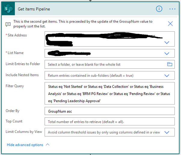

    Thanks for all your help.  I don't have the query with the substringof to give you a screenshot as I'm using it in production now with the column eq value query filter.  Below is a list of the different status values we use currently.  As you can see some have simular words that are meant to group them where others are grouped with dissimilar words.  Each group is broken out into different HTML tables on the report that is generated.   Using the substringof seems a bit more easy and flexable if the values changed rather than the specific column eq value  statement.

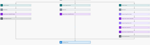

    2020-10-22T20:24:50+00:00
    For the Sharepoint list, what info are you looking for?  Will a screenshot of the list settings page work?  If not please elaborate on what you are looking for. The flow is quite large and prior to this is a bunch of variables and a process to update the Sharepoint items to set a value prior to running this here.
    This is one of the Get Items in the picture above.
