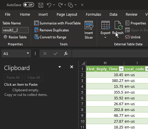

    Hey Alex, thanks for the reply.
    So I've opened the file from scratch and have checked the Clipboard to see that am starting with "Clipboard empty" and tried pasting into NotePad and get nothing.
    I then hit Refresh All to trigger the Power Query refresh. It steps through "Loading Data Model",  "Connecting to datasource..." reading data briefly flashes up and then I get the first error popup. At this point, I switch over to NotePad and can paste an entire column of data.
    I click OK to clear the dialog until it pops up again, then the same column of data is on the clipboard. I click OK again, and then a different column of data is on the clipboard.  21 times it has the one column, then on the 22nd time it's the other column again.  another 20 times and it finally stops showing the error.
