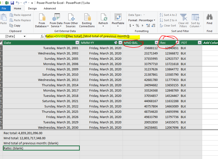

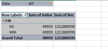

    I have 2 questions below after putting it in my actual data.  Basically, I was able follow your screenshots and do the same thing in my actual data and I was able to create the relationship as well.   Please see below the two images.
    1st question: the image below, if I take pdt column and then take a sub group or attribute like below..the values come out to be the same...why is that happening?  Since I want to be able to use all the column fields to manipulate the data
    2nd question: the second image below, I want to take the ratio as shown in image in the pivot table and use it with all attributes or subgroups.  Can you please help me calculate that so it works with all the sub groups and pdt column as well?  The calculation and the columns are same as in the image that needs to be calculated

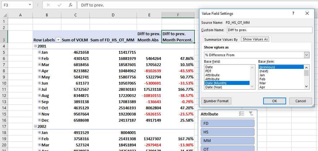

    A ratio is the same as a percentage value, to the previous month we can get that if we group the dates by year and month and show the difference (sample file updated):
    It may be possible that your desired result can be achieved with a DAX formula, but DAX is not my specialty.
    Maybe Ashish Mathur can look at that if you share your file.
