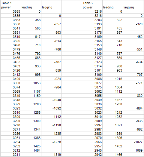

Hello.
I have the following question regarding linearization between data points.
First of all, the format is the following:
x-axis: power
y1 axis: leading
y2 axis: lagging
The tables were previously created by running a macro. The data points are fixed for a specific case (Table 1 = case 1, Table 2= case 2 etc.) BUT: The format for each table is not the same, i.e. the empty cells (no value) in column "leading" and "lagging" are not always on the same position.
Question for macro:
  1. find the cells with no value in column "leading" and "lagging" (= empty cells)
  2. Fill in the "empty cells" by linearizing between data points above and below for column "lagging" and "leading"
Many thanks for your help!
Best, Lucas

  1. HansV 462.4K Reputation points MVP Volunteer Moderator
    2021-03-15T13:18:33+00:00
    Here is some VBA code. Before running it:
    1. Change the column letters in InterpolateAll. As it is now, columns B, C, F and G will be processed.
    2. Change the number 3 in the line FirstRow = 3 to the row below the headers power, leading etc.

  2. Andreas Killer 144K Reputation points Volunteer Moderator
    2021-03-15T13:43:32+00:00
    I calculate different results and the curve or more "smoother" between the points.
    Before you copy the code below into your file please read this article:
    VBA issues with new forum editor - Microsoft Community
    I assume your data is formatted as table, select a cell inside the table, then run the code.
    Andreas.

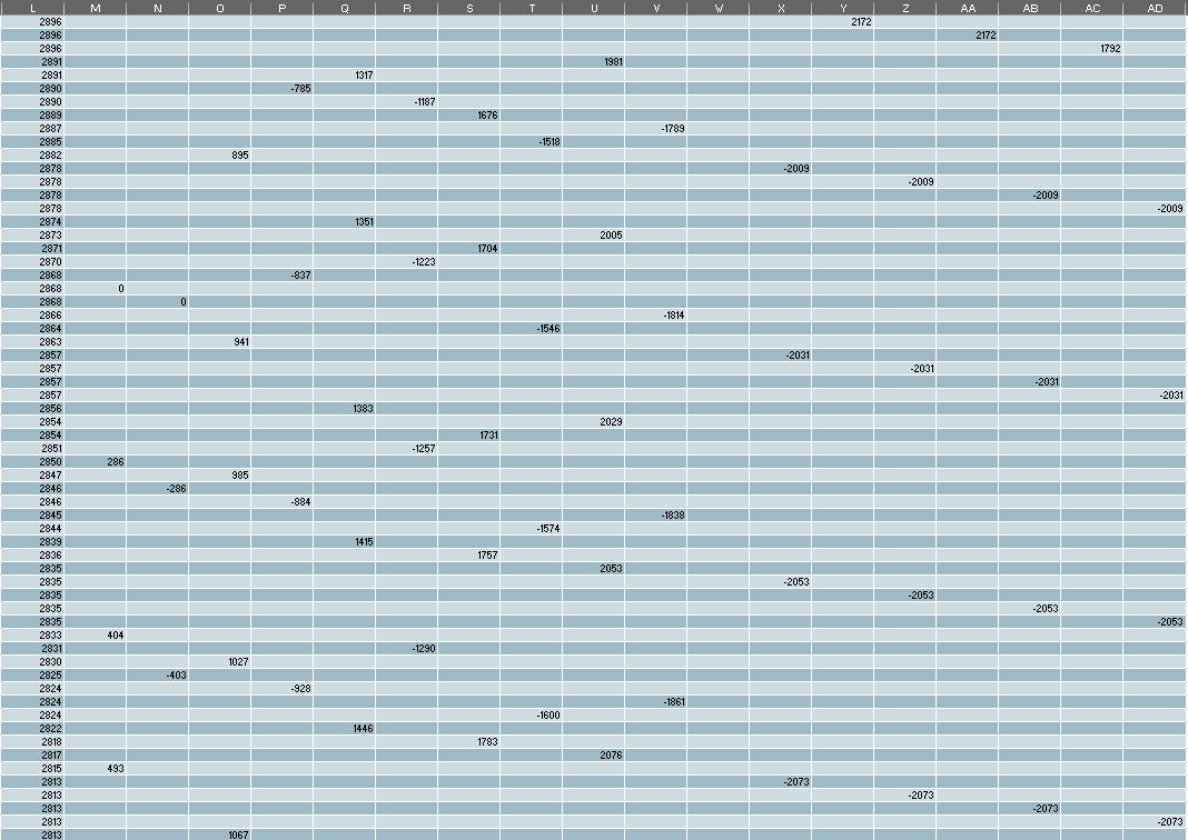

    2021-03-15T23:22:33+00:00
    2021-03-16T09:45:43+00:00
    Many thanks, it works for one table with 3 columns.
    What about this setup, what do I need to change in the code?
