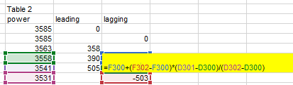

    many thanks, nice code, it works fine BUT the result is different to what I call interpolating.
    If I do the calculation manually, I calculate the following, yellow marked "-450"
    When using your code, the result is different ("-430")
    Why is that?
    Could you correct the code to get -450?
    Many thanks
    Lucas
