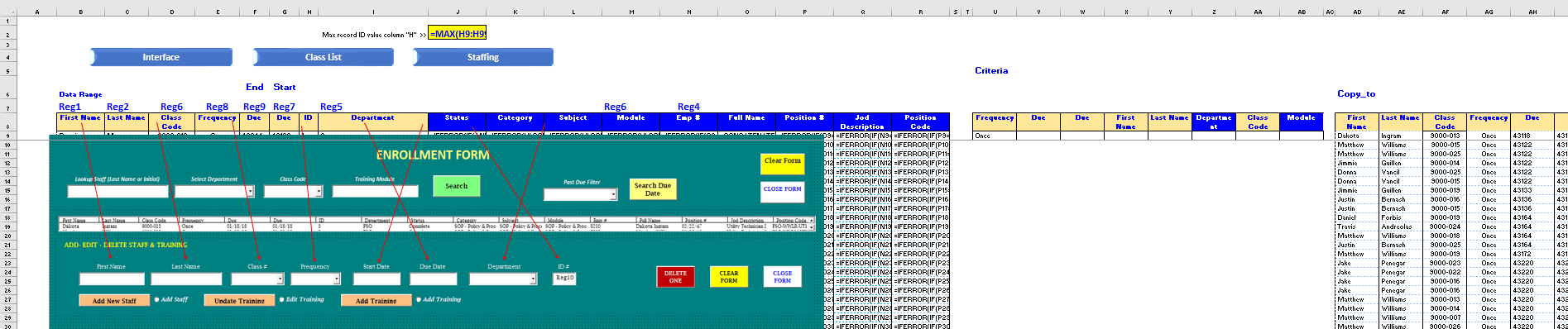

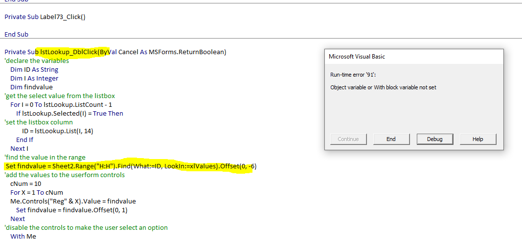

I am getting error code 91 but can't determine what I need to fix.  Everything looks good but I am clearly not right.  This code populates a list box that will populate controls to add training when a line is double ckicked in the box.
Any ideas as to what I can do to fix this?

    First thing I spotted was there is no exit from the For/Next loop after the item is found so the loop continues on.
    For I = 0 To lstLookup.ListCount - 1
            If lstLookup.Selected(I) = True Then
                ID = lstLookup.List(I, 14)
                Exit For                               '<<<<<
            End If
        Next I
    Also, if the item is not found (findvalue is nothing) then
    you need to generate a Msgbox and Exit.

    2021-05-13T13:51:37+00:00
    re:  still have code problems
    I can't run or compile the code as I don't have the Control.
    Strongly suggest the use of Option Explicit
    The following looks about right...
    Private Sub l1stLookup_DblClick(ByVal Cancel As MSForms.ReturnBoolean)
    On Error GoTo errHandler                     '<<<<
    'declare the variables
        Dim ID As String
        Dim I As Integer
        Dim cNum As Long, X As Long         '<<<<
        Dim findvalue As Range
        'error block
        On Error GoTo errHandler:
    'get the select value from the listbox
        For I = 0 To 1stLookup.ListCount - 1
            If 1stLookup.Selected(I) = True Then
             'set the listbox column
              ID = 1stLookup.List(I, 14)
              Exit For
            End If
        Next I
        If VBA.Len(ID) < 1 Then          '<<<<
            MsgBox "No data found"
            Cancel = True                      '<<<<
            Exit Sub                               '<<<<
        End If
    'find the value in the range
     Set findvalue = Sheet2.Range("H:H").Find(What:=ID, LookIn:=xlValues).Offset(0, -6)
    'add the values to the userform controls
        cNum = 10
        For X = 1 To cNum
        Me.Controls("Reg" & X).Value = findvalue
            Set findvalue = findvalue.Offset(0, 1)
        Next
    'disable the controls to make the user select an option
     With Me
        'IS THIS ENABLED SOMEWHERE ELSE OR DOES IT MATTER?  '<<<<
         .cmdAdd.Enabled = False
         .cmdAdd.BackColor = RGB(225, 225, 225)
         .cmdEdit.Enabled = False
         .cmdEdit.BackColor = RGB(225, 225, 225)
         .cmdTraining.Enabled = False
         .cmdTraining.BackColor = RGB(225, 225, 225)
         .optAdd = False
         .optEdit = False
         .optTraining = False
     End With
    Exit Sub                                '<<<<
    errHandler:
        MsgBox "An Error has Occurred "
        Cancel = True
    End Sub
    Note:  A msgbox with the error details could help resolve problems in any code set.
    'Something like this would work...
    VBA.MsgBox "Error " & VBA.Err.Number & " - " & VBA.Err.Description & _
    "   ", vbCritical, "Name of Routine "
    NLtL https://1drv.ms/u/s!Au8Lyt79SOuhiXoNjAh-_-zLi49O

    I should be able to double click the line item in the list box and that data fills the controls underneath, then the code will grey out the boxes and force the user to select one of the options at the bottom.  Here is the  user form on top of the range, criteria, and copy to locations in the worksheet.  Blue is formula driven on the "range" side and all is copied to the right by the use of an advanced filter (below)  After adding everything I started getting error 91"Object variable or With Block not set" through the debugger, and the data will still not load on double click from the list box.
    Sub AdvFilter()
    'Run the advanced filter
    With Sheet2
        Range("B8:R30000").AdvancedFilter Action:=xlFilterCopy, CriteriaRange:= _
            Range("HistData!Criteria"), CopyToRange:=Range("AD8:AT30000"), Unique:= _
            False
            End With
    End Sub
