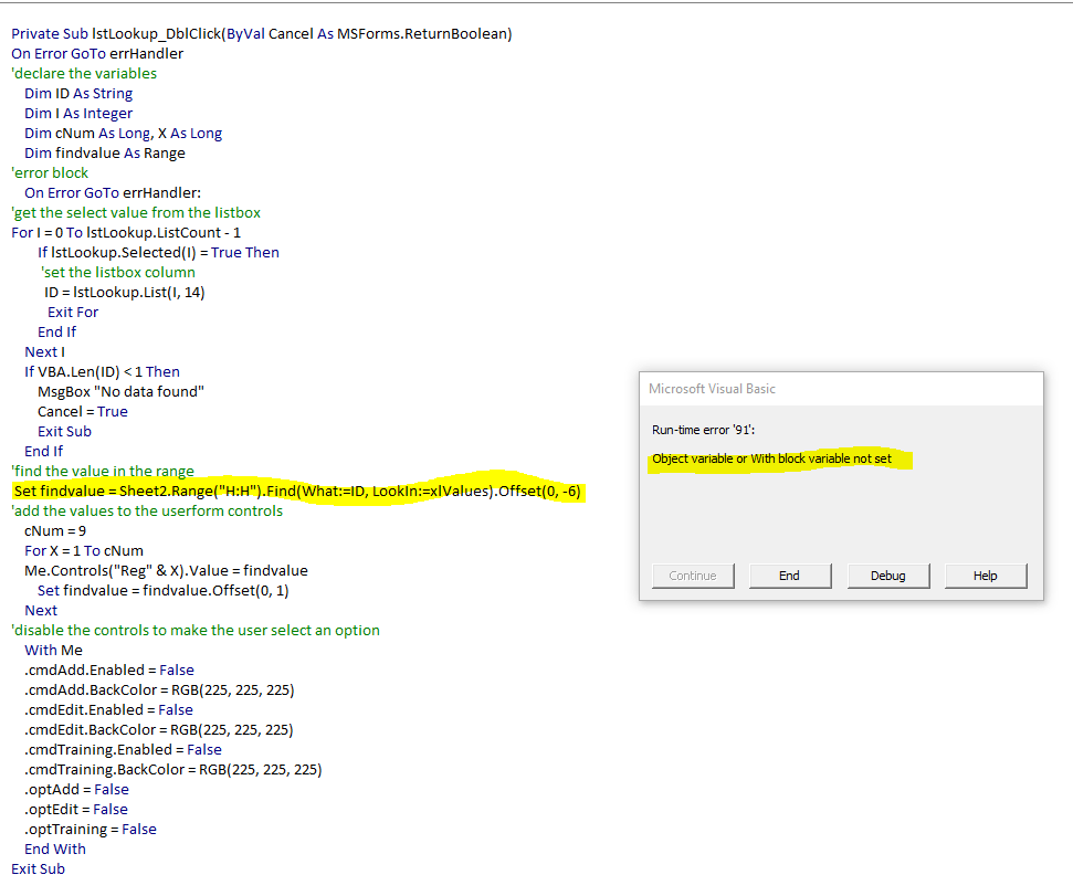

I am getting error code 91 but can't determine what I need to fix.  Everything looks good but I am clearly not right.  This code populates a list box that will populate controls to add training when a line is double ckicked in the box.
Any ideas as to what I can do to fix this?

    Sorry, I should have read closer.  I added the additional code "<<<" and get "Compile Error: Next without For":

    I changed the code as requested and it blew up.  I saw that the code in your "should be" changed the lstLookup to 1stLookup.  Changing that worked but threw another code back to the original issue I was having (see below).

    Thanks for the .Range.  I totally overlooked that piece of code.  This is frustrating for me so I can only imagine how it is for someone that understands more than I do.  I appreciate all your help.  This code works very well in another project I have and am using in the original form. It is nearly identicle to this one and most of the code is the same with the addition of a few more boxes. I do not get any of the errors in that project that I am getting with this project.

    Suggest you check the value of ID and determine if it is in column(H).
