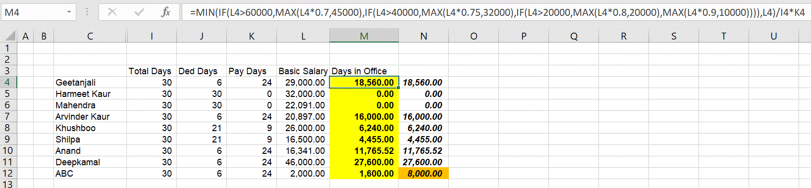

    Formula in cell M4:
    =MIN(IF(L4>60000,MAX(L4*0.7,45000),IF(L4>40000,MAX(L4*0.75,32000),IF(L4>20000,MAX(L4*0.8,20000),MAX(L4*0.9,10000)))),L4)/I4*K4
    Please note that a MIN is used so as to not have the salary exceed L4 viz. refer cell M12 / N12. Cell M12 returns 1,600 ignoring the cap of 10,000 because the salary in L4 is less than 10,000 while cell N12 (without considering the MIN) returns 8,000 after taking into account the cap to be 10,000.

    • What is a CTC? Cost to company
    • Where is CTC on your sheet? Column L Basic Salary
    • What is the CAP? Is it the upper limit, ie pro hockey team salary cap, which means a lower "cap" does not make sense? Or is it "capacity" (doesn't fit with a pay scenario)? it is minimum salary. Even if by calculation of voluntary Pay cut % of the mentioned slab goes below the amount, they will get the said minimum amount
