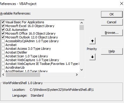

    Hi, I'm Elise, an Independent Advisor and I'd be happy to help with your issue.
    In the VBA editor can you go to Tool > References and then check that the Outlook Object Library has been checked?
    Kind Regards,
    Elise
    2021-07-20T15:00:19+00:00
    Thanks for the suggestion.
    It was not checked, but after I checked it, it still did not run

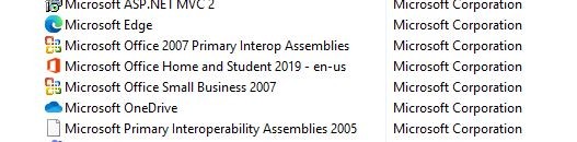

    2021-07-20T15:46:05+00:00
    The other common reason for this is if you have two version of office installed. Eg. 2013 and 2016 editions?
    Do you know if this is the case on your device?
    Kind Regards,
    Elise
    2021-07-20T16:36:12+00:00
    Thanks for the response
    I still have office 2007 installed (but for long time it worked fine with that)
    I used to have some Office 2016 but think it is all gone.
    On the start menu I do have
    Office 2016 Tools
    • database compare
    • office upload center
    • spreadsheet compare
    see below for list of installed Microsoft programs
    Thanks for the assistance
  5. Anonymous
    2021-07-20T17:44:55+00:00
    Thank you all for the assistance.
    I upgraded to Outlook 2019, and it now seems to work.
