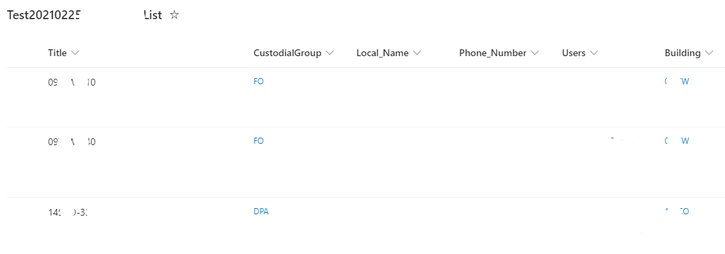

In the below LB_List table, I am trying to copy and make a text version of the Custodial_Group column. This column is a lookup column, which is pulled from the below Faculty_Units table.

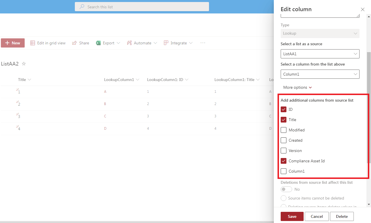

    I notice that you set multiple additional sub lookup columns in the list which is showed in the Power Automate connector and that will cause that Power Automate can't fetch the data from the main lookup column, so the data is null and can't be populated in the single-line text column.
    If the additional lookup columns aren't a must in your environment, one simple way to fix the issue may be to uncheck the additional lookup columns and only leave the main lookup column and then do a test to see the result.
    If the additional lookup columns are a must in your environment, you may use Rest API and some additional formula to get the values from the main lookup column.
    Before creating the flow, I suggest you change the list name and the main lookup column name to a simple name such as ListAA2 and LookupColumn1 in my environment to get rid of some error when running the flow.

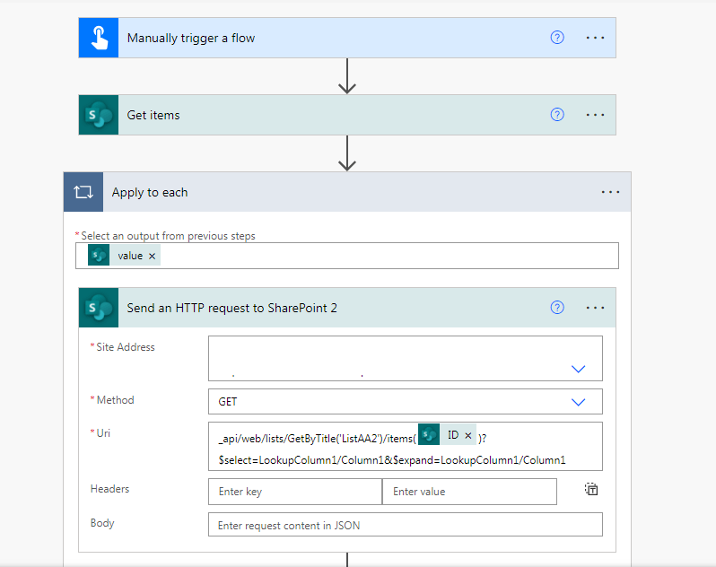

    To get the main lookup column LookupColumn1 value body, use the Get method with Rest API in the Send a HTTP request to SharePoint connector.
    Uri: _api/web/lists/GetByTitle('ListAA2')/items(@{items('Apply_to_each')?['ID']})?$select=LookupColumn1/Column1&$expand=LookupColumn1/Column1

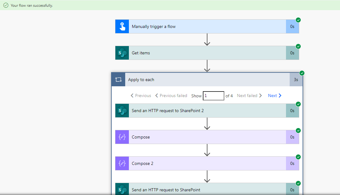

    To get the results part from the body, use the Compose connector with the formula outputs('Send_an_HTTP_request_to_SharePoint_2')?['body']?['d']?['LookupColumn1'].
    To get the LookupColumn1 value from Compose, use the send Compose connector with the formula outputs('Compose')?['results'][0]?['Column1'].

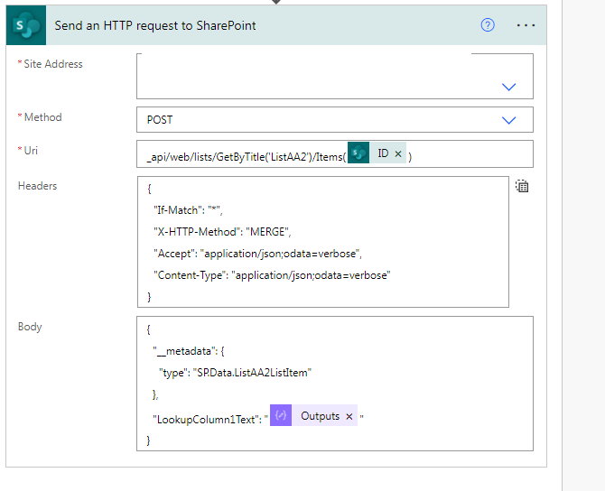

    To populate the LookupColumn1 value in the single-line text column LookupColumn1Text, use the Post method with Rest API in the Send a HTTP request to SharePoint connector.
    Uri: _api/web/lists/GetByTitle('ListAA2')/Items(@{items('Apply_to_each')?['ID']})
    Headers:
    "If-Match": "*",
    "X-HTTP-Method": "MERGE",
    "Accept": "application/json;odata=verbose",
    "Content-Type": "application/json;odata=verbose"
    Body:
    "__metadata": {
    "type": "SP.Data.ListAA2ListItem"
    "LookupColumn1Text": "@{outputs('Compose_2')}"
    Note: You may change the columnname and the list name in your environment.

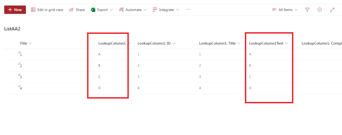

    Result:

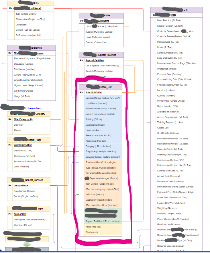

    In the meantime, I just wanted to note that you are correct in pointing out that there are several other lookup columns in this list, which are linked to several other lists. Please see the below diagram- the list I am trying to use for this flow is circled in pink and has 5 lookup columns in total. Each line within the list is a different column (the column type is in brackets after the name). The coloured connector lines show how the lookup lists are connected to each other.
    I am beginning to think that it is this complex architecture of lookup lists connected to other lists that may be the cause of many problems I have been having with Power Automate (this issue is just one!). I am also wondering if using Sharepoint Lists for this 'relational-database' may not be the optimal choice. In your experience, would it be easier to work with this type of relational data in Power Automate (and Power Apps) if the same data was founded in a different source (such as Dataverse or SQL)? I am not an IT expert and neither are most of the users of these lists, so would appreciate any advice on how to make this data easier to work with.

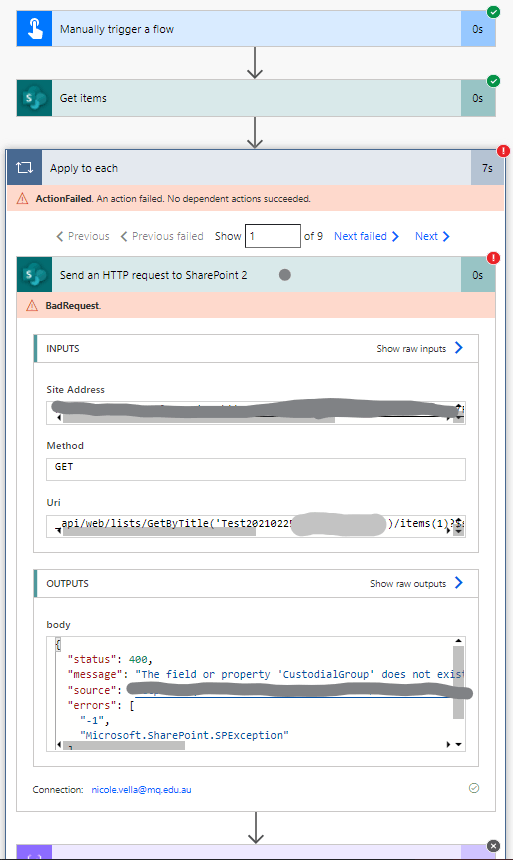

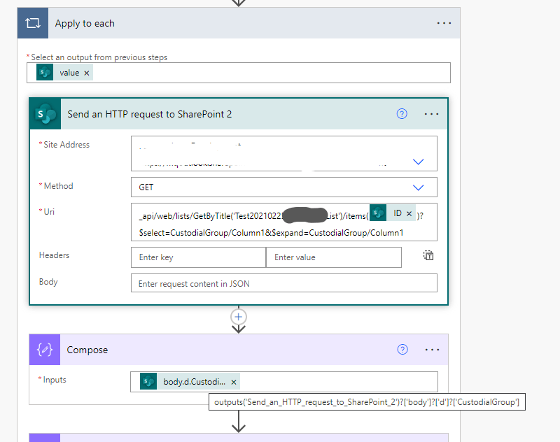

    I tried the Rest API method as you suggested, but there appears to be an error in the Send an HTTP request to SharePoint 2 Step. I am wondering if this may be due to me not correctly replacing part of the formula where you have put 'Column1'? 'Column1' is referred to in several steps in your flow:
    • Send an HTTP request to SharePoint 2
    • Compose 2
    I tried using the column title that appeared equivalent in my lookup list ('Title'), but I had the same error. I would be grateful for your advice on how I can rectify this error:
    The full error message is:
    { "status": 400,"message": "The field or property 'CustodialGroup' does not exist.\r\nclientRequestId: ****\r\nserviceRequestId: ***","source": "https......_api/web/lists/GetByTitle('Test20210225....List')/items(1)?$select=CustodialGroup/Column1&$expand=CustodialGroup/Column1","errors": ["-1","Microsoft.SharePoint.SPException"]}
    Here is what I currently have entered for this step:
    Uri: _api/web/lists/GetByTitle('Test20210225....List')/items(@{items('Apply_to_each')?['ID']})?$select=CustodialGroup/Column1&$expand=CustodialGroup/Column1

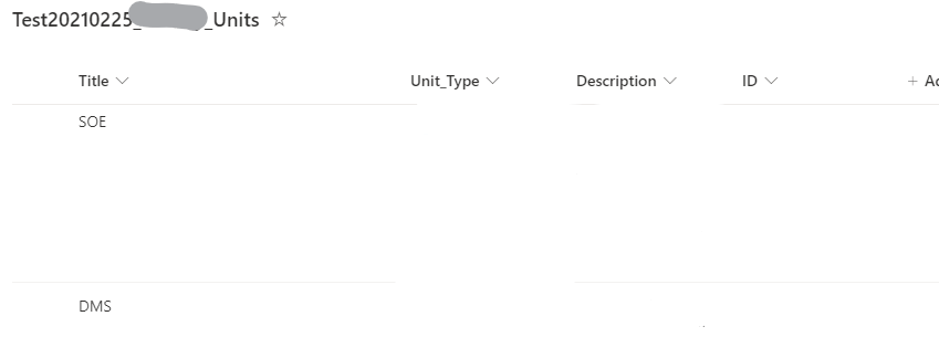

    This is my lookup List:
    This is my list that I am using in this flow (wanting to copy and make a text version of the CustodialGroup column, which data is a lookup from the 'Title' column of the above Units list.
