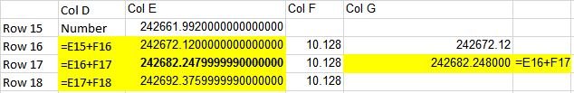

Ok So I created a series of numbers by adding +10.128 to the cell on the row above!
See the error on cell E17 answer should be the same as Cell G17 242682.248000
This error throws out my tests with VBA

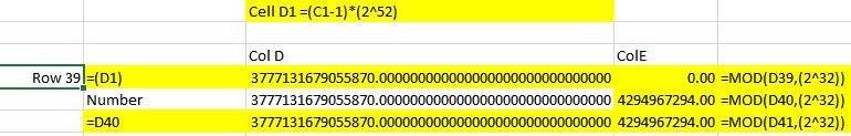

I have also seen this with the worksheet function Mod
the answer in cell E39 is wrong
    This is a common problem, because most decimal fractions cannot be represented exactly in 64-bit binary floating-point, which is what Excel uses for storing numeric values internally and for performing arithmetic.
    Moreover, the binary approximation of a particular decimal fraction might vary depending on the magnitude of the number. That is why, for example, 10.01 - 10 = 0.01 returns FALSE(!). The approximation of 0.01 in 10.01 differs from the approximation of 0.01 itself.
    In general, the work-around is: whenever we expect a calculation that involves decimal fractions to be accurate to some number of decimal places, explicitly round to that number of decimal places -- and not to an arbitrary number, as some people suggest.
    In your example, change =E15+F16 to =ROUND(E15+F16, 3) .
    However, we cannot duplicate the misbehavior with just the values that you provided. The value that is displayed in E15 (242661.992) must have been calculated. It, too, should be rounded, as a matter of principle.
    You can confirm that E15 is not the exact binary approximation of the displayed value by entering the formula
    =SUM(E15, -(E15 & "")), formatted as Scientific.
    FYI, we cannot write simply =E15-(E15 & "") because sometimes Excel arbitrarily replaces the infinitesimal difference of the last subtraction in a formula with exactly zero. (sigh)

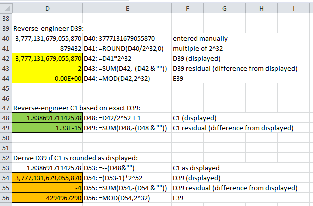

    But I suspect that is not the issue here. Instead, I suspect the issue is: Excel formats only up to the first 15 significant digits, and the value in D39 is actually the exact integer 3777131679055872, an exact multiple of 2^32. So, the MOD expression in E39 is correct to return zero.
    Your own experiment in D40 demonstrates that the value in D39 is not what it appears to be. Because if it were, the calculations in E39 and E40 would have the same results.
    Instead, let's assume that the MOD calculation in E39 is correct, and the value in D39 is an exact multiple of 2^32. Then:
    D41 calculates an exact multiple of 2^32 close to the value displayed in D40, namely 879432.
    D42 calculates the exact integer that should be in D39, namely 879432 * 2^32.
    Contrary to everything you might read, Excel calculations are __not__ limited to 15 significant digits.
    Instead, Excel can accurately calculate all integers up to 9,007,199,254,740,992 (2^53), which is 16 digits. Since that is larger than the expected integer in D39, we can expect the calculation in D42 to be an exact integer.
    And as the calculation in D43 demonstrates, the value in D42 is really 3,777,131,679,055,872 -- 3777131679055870 displayed in D42 plus 2, the residual displayed in D43.
    We cannot see the last digit because, again, Excel arbitrarily formats only the first 15 significant digits (rounded), replacing any digits on the right with zeros.
    Based on the correct value in D42, we see in D44 that MOD(D39, 2^32) correctly returns zero.
    Possible TMI follows....
    In D48, we reverse-engineer what your value might be in C1, based on the correct value for D39, which we calculate in D42.
    D49 shows the residual difference from what Excel formats in D48. In other words, the value in D48 is actually
    1.83869171142578 + 1.33E-15 (approximately).
    PS.... In general, because you format E39 as Number with 2 decimal places, we do not really know that it is exactly zero. We can only recognize exact zero by formatting as Scientific (0.00E+00) or by testing =E39=0 (TRUE). Even when formatted as General, 0 might not be exactly zero sometimes. Again, for a dispositive explanation, it is best to provide an example Excel file, not images or descriptions, which are subject to interpretation.
    However, in this particular case, because we multiply C1 by such a large factor (2^52), the residual can only be 1.33E-15 (3*2^-51), due to the limited precision of 64-bit BFP. Even 4*2^-51 (1.78E-15) and 2*2^-51 (8.88E-16) would cause visibly different results in E39.
    The calculations in D53:D56 demonstrate the importance of the residual difference that Excel does not normally display.
    In D53, we round D48 to the displayed 15 significant digits.
    Then we derive the value in D54 with a formula similar to your formula in D1.
    Note that D54 is 3,777,131,679,055,866 -- 3777131679055870 displayed in D54 minus 4, the residual (-4) displayed in D55. It is not 3,777,131,679,055,872, which we presume D39 actually is.
    And MOD(D54,2^32) in D56 is 4294967290, not zero as your E39 is.
    So, we need the hidden residual difference in C1 in order to calculate D39 and E39 correctly.
