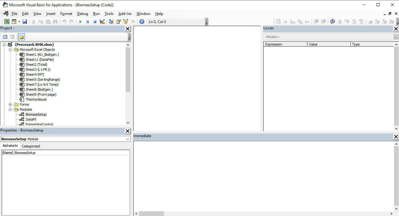

I have been working on a macro-enabled workbook. Today when opening the sheet, I get this error for each module:
After pressing "ok" for each "missing module" I get this error:
When accessing Visual Basic I can se the modules in the project explorer, but they are all empty?
I have selected the "BiomassSetup" module in the picture below:
If the file can't be fixed, is it then possible to get my code back?
Hope that you guys can help. It's approximately a weeks coding I'm missing...

    Have a look at the following link and see if it helps. Note that it is a non Microsoft site but is a popular site for Excel Users.
    https://www.ozgrid.com/forum/index.php?thread/1203639-vba-window-shows-list-of-modules-but-does-not-show-any-code/

    Also try the "Reset" button that I have marked with the red enclosure on the following Screen Shot. The code might be stalled somewhere due to an error in event code that runs when the workbook opens.

    I tried this. But this wasn't the issue. I noticed that the file went from 450 kb to 6 Mb later that day. The file was definetly corrupt. I had the file on sharepoint, but all previeous versions had the same error. Then at the end of the day, I accessed the sharepoint through my browser, and downloaded a version. This version worked. I have no idea of what happened... Thank you for your help! I'm always learning and am greatful for the link you send. I'm definitetly gonna check out the forum.

    It was assuming that you have a workbook Open event. The Stop simply stops the code from continuing to run past that point. The VBA editor should open with the Stop line highlighted. If you click the Reset button then that stops all of the code and the workbook has then opened without the Workbook Open code running.
    However, if you now have a downloaded version of the workbook with the code running satisfactorily then corrupted workbook is more likely the problem you were having.
