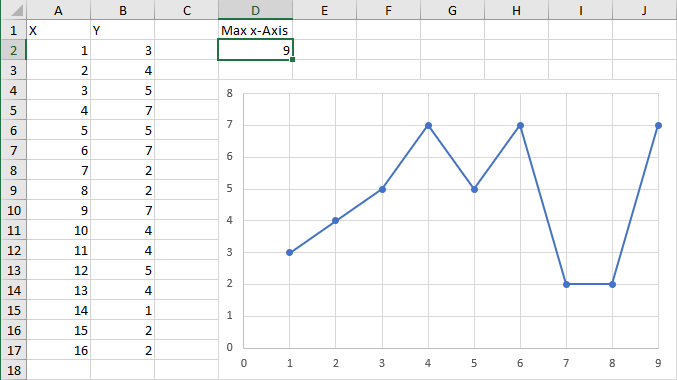

    Here is a simple example:
    The worksheet module contains the following code:
    Private Sub Worksheet_Change(ByVal Target As Range)
        On Error GoTo ErrHandler
        If Not Intersect(Range("D2"), Target) Is Nothing Then
            If Range("D2").Value <> "" Then
                Me.ChartObjects(1).Chart.Axes(xlCategory).MaximumScale = Range("D2").Value
            End If
        End If
        Exit Sub
    ErrHandler:
        MsgBox Err.Description, vbExclamation
    End Sub
    When you change the value of cell D2, the x-axis will automatically be adjusted.
    To activate the worksheet module, right-click the sheet tab and select View Code.
    Don't forget to save the workbook as a macro-enabled workbook (*.xlsm) and to allow macros.
