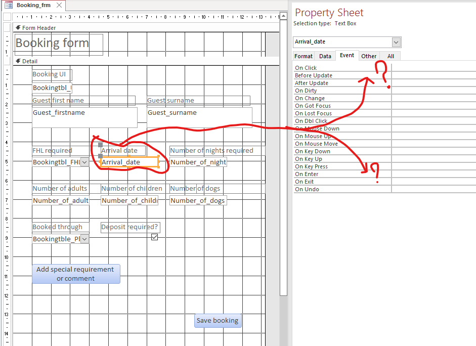

    Ken,
    Thanks for trying to help me.
    However, I am very confused. Do I input your first code in your first reply into the "Before Update" event for my Arrival date field or do I put it somewhere else? If it goes somewhere else, how do I use it to check that the Arrival date I am inputting is checked against existing data? What starts it?
    Honestly, I have not got a clue when it comes to things like this.
    If you can show me that would be great. But if I've taken up too much of your time, I understand and thank you for the help you've already given me.
