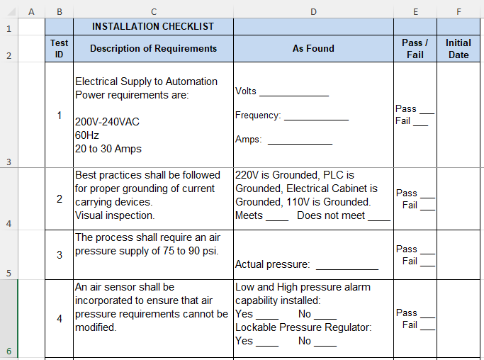

    You might have seen I updated my original post, and included an image of how the end user
    sees it.
    Im guessing that I can hide column A just to prevent distraction if A2 was where I was to
    paste and extend it on down, and just let my Print Area in Excel to never see that column.
    The problem Im having, (at least the way I interpreted you code you kindly sent,
    is that column A is the one that is being updated, and displaying correctly,
    even when I insert a copied cell(row), or hide a row, and column B is not updating, which is part of
    the rows and contents.(which I wrongly called a table)
    Its column B that I was hoping to update, and I think thats what you intended?
