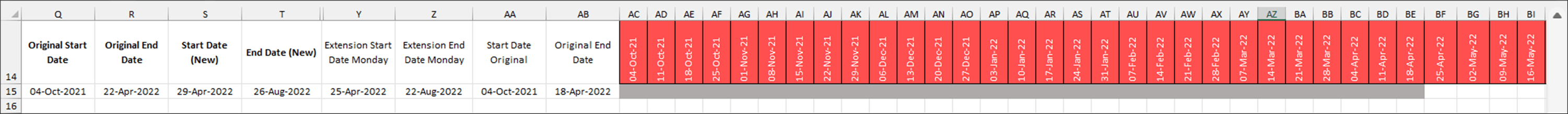

I've been asked to include 2 new date ranges into my Gantt chart. I've inserted helper columns where IF formulas feed off to populate the gantt view.
The 2 new helper columns are in column Y & Z and im trying to include these date ranges into the below if Formula;

    Your initial formula doesn't factor in the other IF statements I want included in the overall formula.
    The second formula you provided is working, however isn't capturing the full date range, it still seems to stop at the original end date 28/03/22, where it should stop at the furthest date which in this case is the Extension end date of the 26/09/22...?

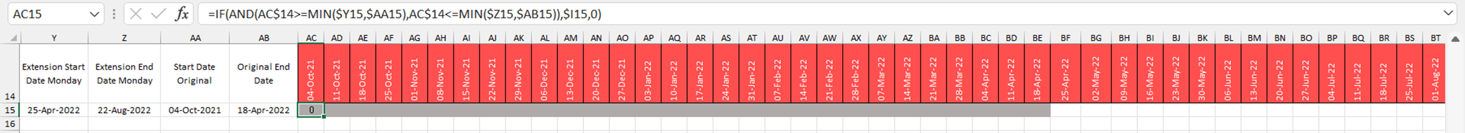

    2022-04-29T10:34:25+00:00
    Hi
    I'm trying to integrate the first above formula into the existing IF formula, however it isn't working.
    Can you please incorporate it into the below formula like you did initially? (view below screenshot)
    **=IF(AND(AC$14>=MIN($Y15,$AA15),AC$14<=MIN($Z15,$AB15)),$I15,0),**IF($I15="Employee (perm/fixed term/internal)","Employee (perm/fixed term/internal)",IF($I15="Contractor","Contractor",IF($I15="New Recruit - External","New Recruit - External",IF($I15="SOW (Statement of Work)","SOW (Statement of Work)",IF($I15="New Recruit - Perm","New Recruit - Perm",0))))),0),0)
