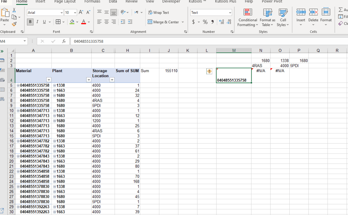

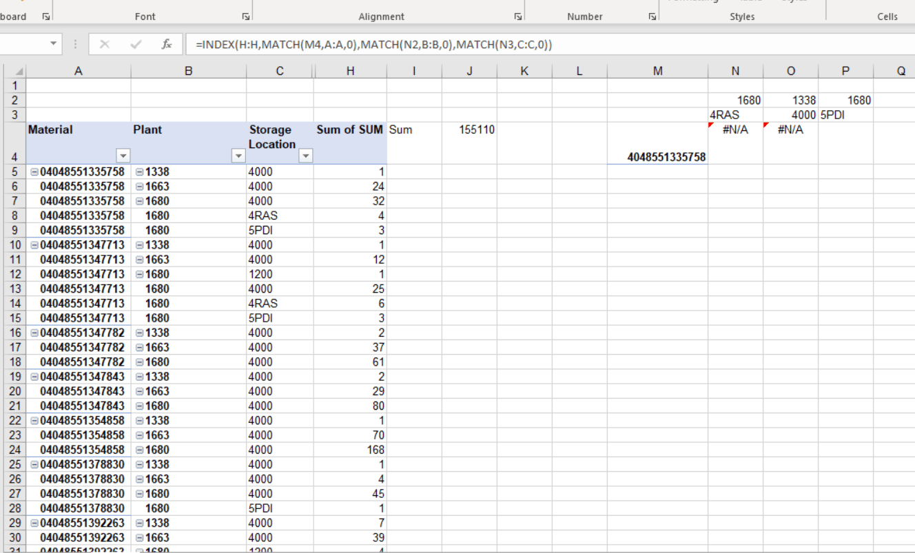

Hi Experts,
I received #N/A error when using th formula =INDEX(H:H,MATCH(M4,A:A,0),MATCH(N2,B:B,0),MATCH(N3,C:C,0)) in the table. How the error should be rectified by using the index and match formula and I appreciate if someone tells the vba code to process this!

  1. riny 20,530 Reputation points Volunteer Moderator
    2022-10-29T08:31:33+00:00
    Column A contains texts containing 14 numeric characters, all starting with a zero. M4 contains what seems to be a 13-digit number. Hence, no match will be found, #N/A as the result.
    2022-10-29T08:39:51+00:00
    I included 0 in the M4 but it was not shown?
    2022-10-29T08:42:33+00:00
    Can you have a look at this?
  4. riny 20,530 Reputation points Volunteer Moderator
    2022-10-29T09:21:57+00:00
    Can't tell from a screen shot. What do you get when you enter
    =M4=A5
    anywhere. I suppose these are supposed to be the same. If you see FALSE, then these cells are not equal. Do the same for N3 and C8. There could be trailing spaces or other invisible characters. Then MATCH will return an error.
