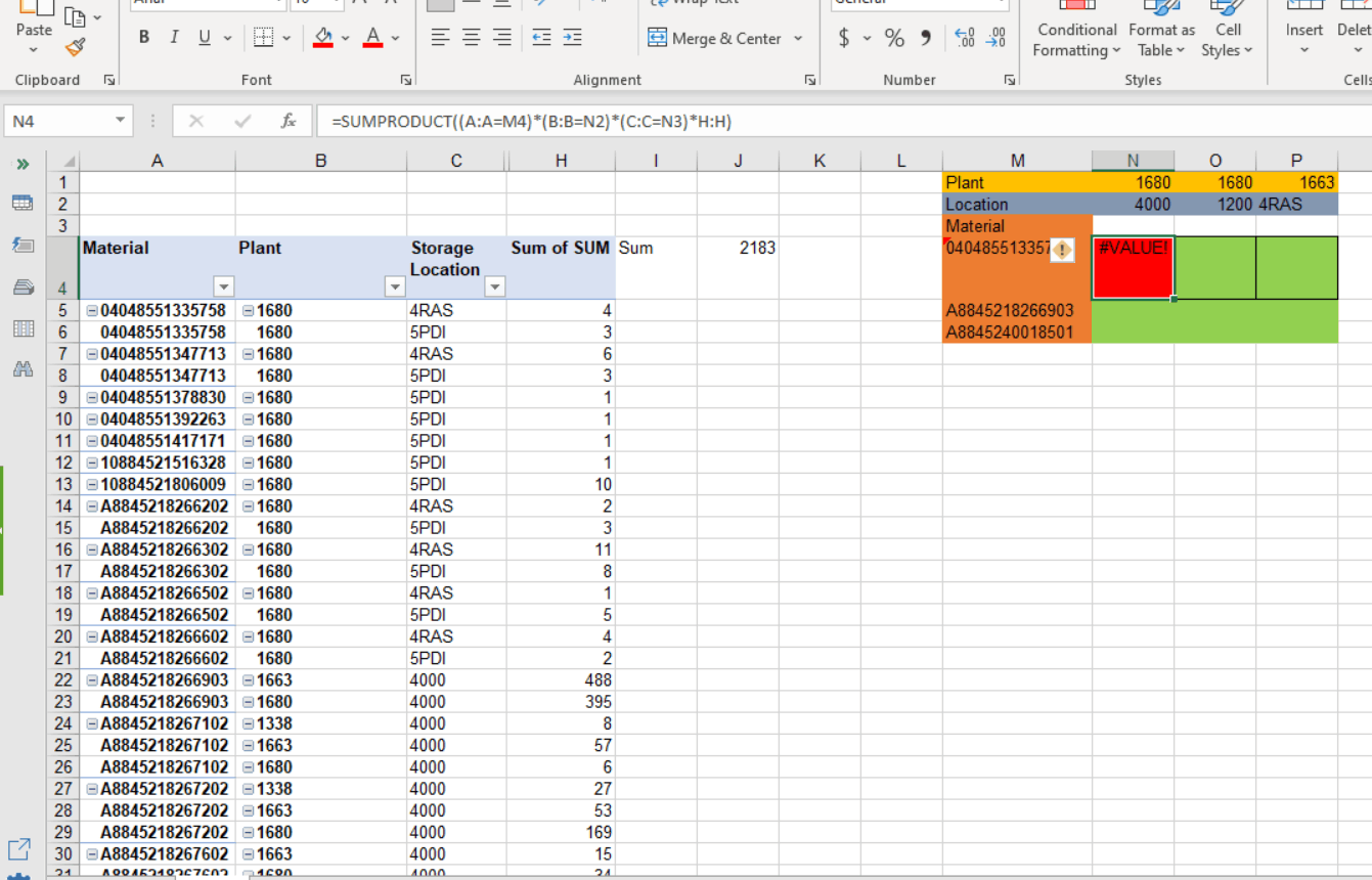

Hi Experts,
I received #N/A error when using th formula =INDEX(H:H,MATCH(M4,A:A,0),MATCH(N2,B:B,0),MATCH(N3,C:C,0)) in the table. How the error should be rectified by using the index and match formula and I appreciate if someone tells the vba code to process this!

    Did some more testing. On a Pivot table this time. The PT headers cause a Value error when you multiply the first three arrays with H:H.
    Include an IFERROR inside the SUMPRODUCT like this:
    =SUMPRODUCT(IFERROR((A:A=M4)*(B:B=N2)*(C:C=N3)*H:H**,0)**)
    As said earlier, SUMIFS doesn't have this problem.

    the above formula, still it doesn't work. I want to look up the value in H based on 3 criterias ; material, plant, storage location
  2. riny 20,530 Reputation points Volunteer Moderator
    2022-10-29T10:09:38+00:00
    In an earlier screenshot you were looking at N2 and N3. Now these are N1 and N2 but you didn't adjust the formula!! But that should just result in a zero.
    Change the cell references and the formula should work. Perhaps you have a value error in any of the four columns referenced. Then SUMPRODUCT will throw out a value error as well. SIMIFS will work, though.
