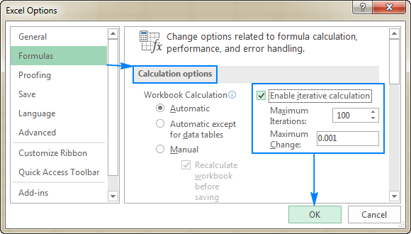

Hello Microsoft Community,
I have created shared excel file on SharePoint, in which I have some formula having own cell reference hence I am getting circular formula error. And to solve that error I have tick marked Enable iterative calculation as highlighted in below image. But this tick automatically disable everyday meaning everyday I have tick again.
how we can resolve this issue? Means tick on "enable iterative calculation" once not everyday.
Thank you in advance

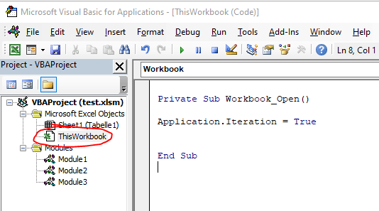

    Excel will apply/use the calculation settings of the first workbook you open in a session. So, if you first open workbook A (which had iteration disabled when it was last saved) and then Workbook B (with iteration enabled when it was last saved), Excel will keep iteration disabled.
    As workaround, save the file as xlsm(Macro enabled workbook), Then copy the code to "this workbook".
    This code will set the iteration enabled when the workbook is open.
    Private Sub Workbook_Open() Application.Iteration = True End Sub
