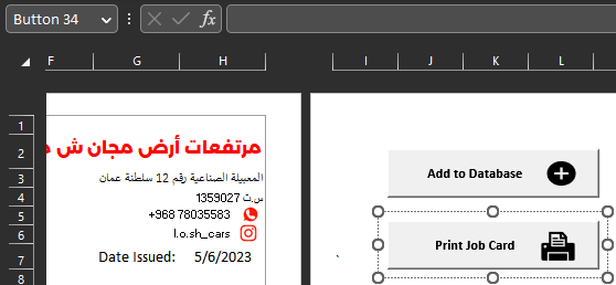

I need to remove a specific shape under my Macro-Enabled Workbook.
What I want is when I click on "Add to Database" button, the active workbook will be saved as a new workbook on a specific path and filename as .xlsx
under the image below I encircled those Buttons that I need to remove, however, I only have a code that will remove all the shapes under my worksheet, including my logo photo, checkboxes, and text box...
Here's the code:

Only those buttons (form button) that I want to remove.

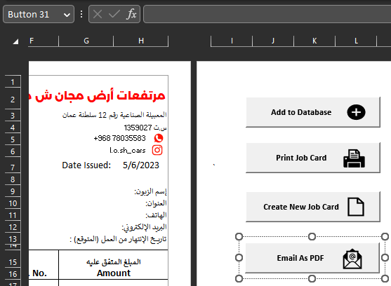

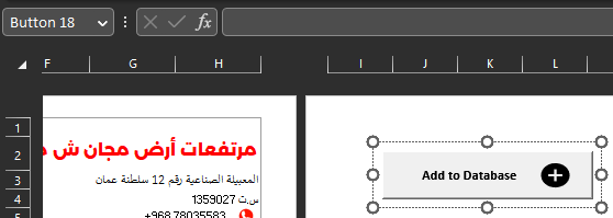

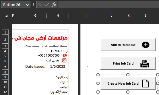

  1. HansV 462.4K Reputation points MVP Volunteer Moderator
    2023-06-04T21:46:54+00:00
    I assume that the buttons that you encircled are ActiveX command buttons.
    On the Developer tab of the ribbon, in the Controls group, click to highlight Design View.
    Click on the first button and you'll see the name of the shape in the name box on the left hand side of the formula bar.
    Select and copy the name. For illustration purposes, I'll use CommandButton1.
    Switch to the Visual Basic Editor and insert the line
        ActiveSheet.Shapes("CommandButton1").Delete
    where CommandButton1 is the name of the button shape.
    Switch back to Excel, and repeat these steps for each of the other buttons.
    When you're done, click to unhighlight Design View.
    (And don't forget to remove the loop that deletes all shapes!)
5 additional answers
    2023-06-04T21:50:34+00:00
    those buttons are under "FORM CONTROLS" is it the same when I use the code you recommend?
  2. HansV 462.4K Reputation points MVP Volunteer Moderator
    2023-06-04T21:56:11+00:00
    In that case, you don't have to activate 'Design View'. Instead, right-click on a button to select it.
    The rest remains the same.

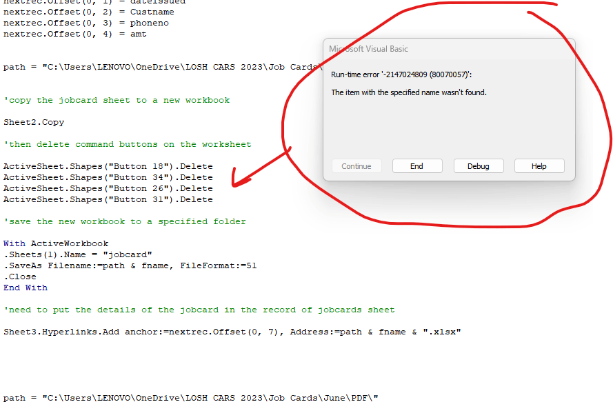

    2023-06-04T22:23:34+00:00
    I got this Error.
