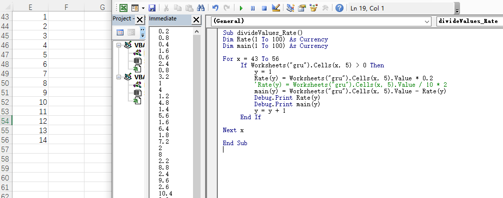

    2023-06-28T02:29:49+00:00
    Try this one:
    Sub divideValues_Rate()
    Dim Rate(1 To 100) As Currency
    Dim main(1 To 100) As Currency
    For x = 43 To 56
     If Worksheets("gru").Cells(x, 5) &gt; 0 Then
         y = 1
         Rate(y) = Worksheets("gru").Cells(x, 5).Value \* 0.2
         'Rate(y) = Worksheets("gru").Cells(x, 5).Value / 10 \* 2
         main(y) = Worksheets("gru").Cells(x, 5).Value - Rate(y)
         Debug.Print Rate(y)
         Debug.Print main(y)
         y = y + 1
     End If
    Next x
    End Sub
