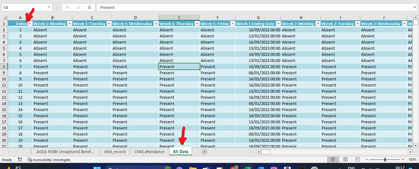

  5. Anonymous
    2023-04-22T18:23:47+00:00
    Hello,
    Thank you for your time on this.
    The last sheet (All Data) on your file has the same issue I faced; the total number of students is about 1882 so the index should be about that but I ended up with 5000+
    Therefore we should have the attendance have the same number of rows so it can be merged with the Child_record sheet and give us a final sheet with the students and their attendance.
    Kindly check Bernie's file.
    But I also want to try and learn other methods so if you can get it to work using a different approach kindly assist.
