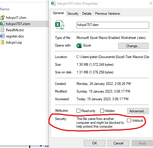

    I downloaded the file and extracted it. (I did not try to open it inside the Zip file so that I can keep the original download).
    I then navigated to the file in Windows Explorer, right clicked the file and got the result as per the screen shot below, showing the file is blocked.
    I checked the Unblock box -> Clicked Apply -> OK (Note must click Apply before OK or does not work)

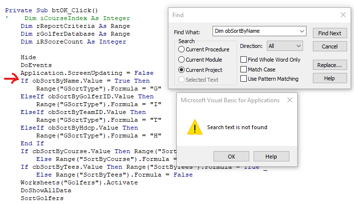

    I then opened the file in Excel and got the message "variable not defined" and it highlighted obSortByName as the error.
    I used the Find Feature in VBA and set the parameter to "Current project" and I cannot find the Dim statement anywhere in the project. See second screen shot below.
    Please advise if I am missing something because the variable appears in multiple subs throughout the project so probably needs to be dimensioned as a public variable.

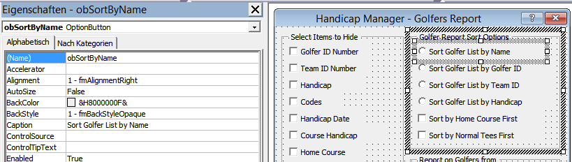

  2. Andreas Killer 144K Reputation points Volunteer Moderator
    2023-01-15T08:34:32+00:00
    That is a control inside the form:
    Unfortunately I can't reproduce the error because I don't have the version.
    I suspect the problem is related to the MsForms DLL, resp. the controls. If you can use Userforms without issues in a new file, I would try the VBA Code Cleaner to rebuild the project. And delete the *.exd files too.
