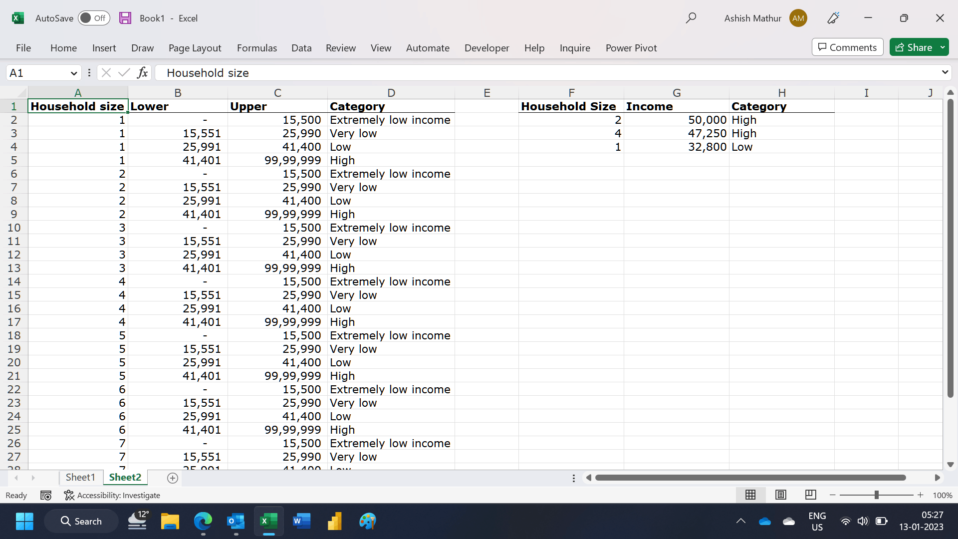

    If you are Ok with transforming your first table like the one shown in the image below, then this formula will work in cell H2
    =XLOOKUP(F2&G2,$A$2:$A$33&$B$2:$B$33,$D$2:$D$33,"",-1)
    Hope this helps.

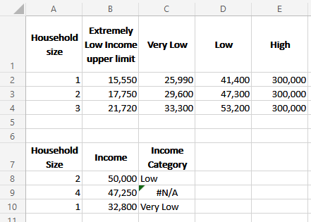

  1. Andreas Killer 144K Reputation points Volunteer Moderator
    2023-01-12T16:07:48+00:00
    C8: =INDEX($A$1:$E$1,MATCH(B8,FILTER($A$1:$E$4,$A$1:$A$4=A8)))
    Sample file:
    https://1drv.ms/x/s!AsEpmlJLteasjlTdf0bf5ASJA8Tb?e=harIC6
    2023-01-12T16:18:42+00:00

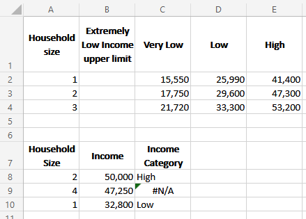

    Hello! thanks for the quick reply, but it looks like the result is wrong for the first example (C8). If the household size is 2 and the income is 50,000, the household would be considered a high income category, not low. The numbers provided in the table are the upper limit that place someone in that category. Do you know how to fix that? The third example (C10) is correct though. Do I just need to change the ranges to the minimum value instead of the maximum income value?
    2023-01-12T16:36:26+00:00
    Great, thank you so much!!!
