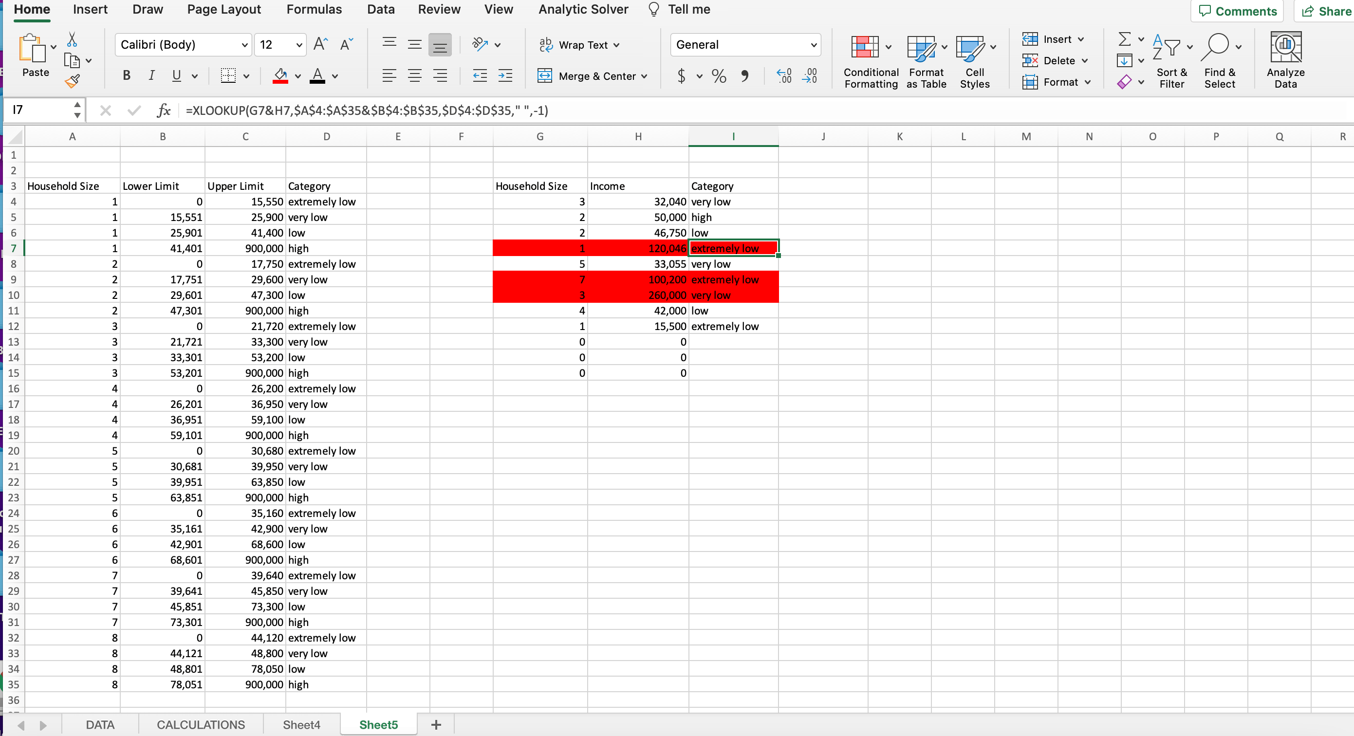

    If you are Ok with transforming your first table like the one shown in the image below, then this formula will work in cell H2
    =XLOOKUP(F2&G2,$A$2:$A$33&$B$2:$B$33,$D$2:$D$33,"",-1)
    Hope this helps.

    Hello! Thanks for the reply, I tried it this way but there seems to be an issue with income values larger than 99,999 , as the resulting categories are wrong. I have highlighted the categories that are incorrect in red. DO you know how to solve this? Thanks in advance for the help!

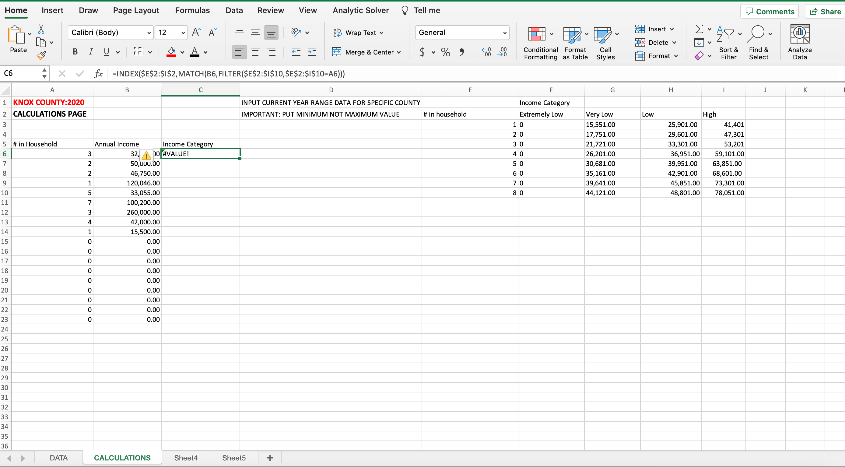

    Hello again! I went ahead and tried it this way but there seems to be an error somewhere in my formula. Do you know how to fix it? Thanks in advance!
  3. Ashish Mathur 100.8K Reputation points Volunteer Moderator
    2023-01-20T00:09:35+00:00
    Share the download link of the MS Excel file in which you are facing that error. Let your formulas stay in the file.
