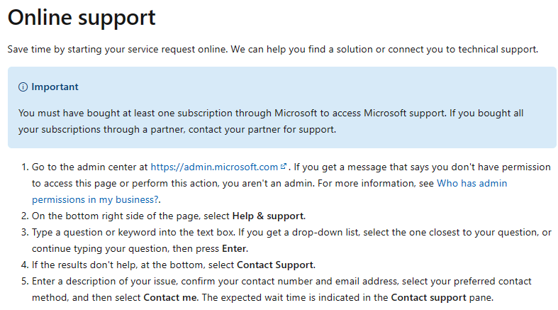

    I do understand your query here but, your query needs to be checked from back-end side, and since we are belong to Microsoft Community site, we have limited resource and privilege to examine back-end related scenarios. Therefore, for your concern, I sincerely recommend that you contact our dedicated technical support team via admin center Get support - Microsoft 365 admin | Microsoft Learn.
    Since, our dedicated technical support team have more resources than us, they will check your query from back-end side and will assist you with possible solutions.

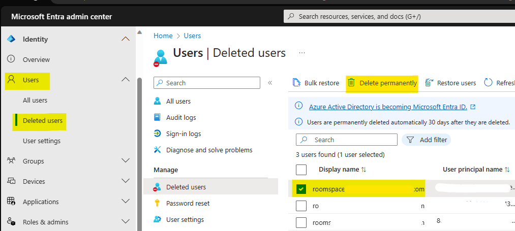

    • If you are using Exchange Online, may I please confirm if you checked if the room mailbox in question is listed in the deleted users? if you haven't check it yet, please kindly go to Microsoft 365 admin center -->Users -->Deleted Users.
    • If the room mailbox in question is listed in the deleted users, please kindly go to Azure active directory (https://entra.microsoft.com/)-->Users -->Deleted users -->select the room mailbox -->Delete permanently. See the screenshot below.
    Exactly. I have removed the user from Deleted Users and waited for 12 hours still it's not possible to create a User/Mailbox/Workspace on the other tenant.
