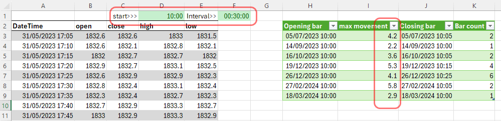

    However, I would like to test the specified time interval at a specific time of the day. So, let's say 50 minutes each day at the same time of the day. For example, start at 09:00 and end at 09:50 every day.
    See linked-to file below.
    Long trades only.
    Sheet1: Specify start time in cell D1, length in cell F1
    Result (green) table at cell H2. Needs refreshing like a pivot table: right-click somewhere in the green table and choose Refresh.
    It lists only trades which could be exited at a profit, even if that happens in the same bar as the entry (as long as that bar opens at its low).
    Sheet2: Previous 'every-n-minutes' solution as specified in cell F1 of Sheet1. Refresh to update it.
    The workbook: https://app.box.com/s/9ywmgjqp087jzc3kr9zdiyjxtjf2thsw
    I wasn't expecting it will be so complex and difficult
    I agree, those formulae are very difficult to adjust/maintain, hence the attached.

    The one thing that I'm worried about is that I could mislead, or we could misunderstand each other, about "time interval." The way I understand it now is that we test every 50 minutes. (pls correct me if I'm wrong)
    I apologize if it comes from my side.
    That formula in the M column, ohh my ohh my. I don't even know where to start.
