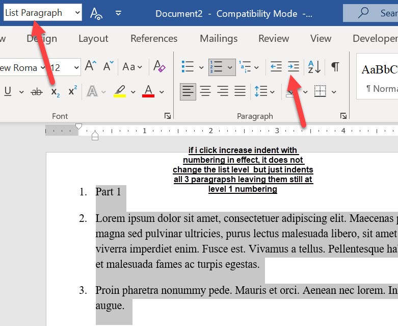

See picture 1 below, when I select the 3 paragraphs and click Increase Indent icon (or press the shortcut Tab key), I don't get what I get most of the time. That the list level would change from level 1 to level 2. What I get is that all 3 paragraphs are indented .25 inches or .5 inches but remain at level 1 numbering. So then I have to undo the indent change, click the Multi-level list button, point to Change List Level and click Level 2. This takes longer.

    When the first item of a list is at the first level, it can't go to a second level because there is no first level item to precede it. It only indents.
    Test on the second level, or add more first level lines below the first one.

    You can use Alt+Shift+Left Arrow to promote and Alt+Shift+Right Arrow to demote the list level.
    2023-12-08T13:06:51+00:00
    thanks so much for that additional shortcut!!
    however it did not resolve the matter ....when i used it ...after highlighting the 1st 3 para. it still did not change list levels

    Are you sure those paragraphs are part of a multilevel list?
    2023-12-08T14:01:58+00:00
    thanks for your note and offer to help...really appreciate your time
    Yes, I'm sure because when i highlight the 1st 3 para and click multi-level list then go to change list level and pick level 2 (which is a.) the 3 para numbers do change to a., b., c.
