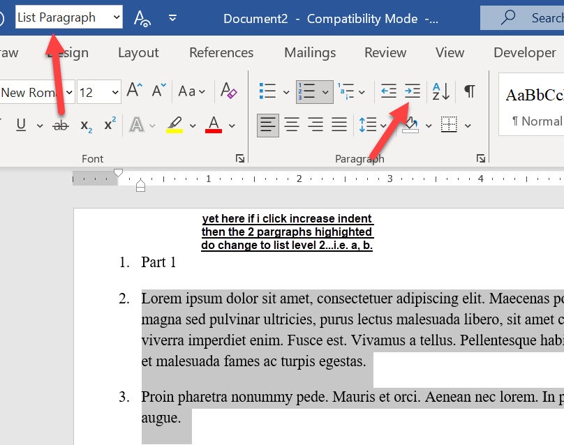

See picture 1 below, when I select the 3 paragraphs and click Increase Indent icon (or press the shortcut Tab key), I don't get what I get most of the time. That the list level would change from level 1 to level 2. What I get is that all 3 paragraphs are indented .25 inches or .5 inches but remain at level 1 numbering. So then I have to undo the indent change, click the Multi-level list button, point to Change List Level and click Level 2. This takes longer.
See picture 2 below, here when I select these 2 paragraphs and click the Increase Indent icon (or press the shortcut tab key), the list level DOES change from level 1 to level 2 which is normally the result I get. So here I would get both paragraphs numbered a. and b.

    When the first item of a list is at the first level, it can't go to a second level because there is no first level item to precede it. It only indents.
    Test on the second level, or add more first level lines below the first one.
