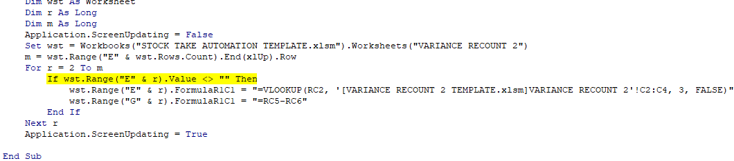

    Hi Hans
    So the "Subscript out of range" error is gone now.

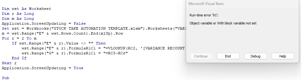

    On the first try it kept looping but not doing anything.
    On the second try I got the following error: On debug, see highlighted error:
