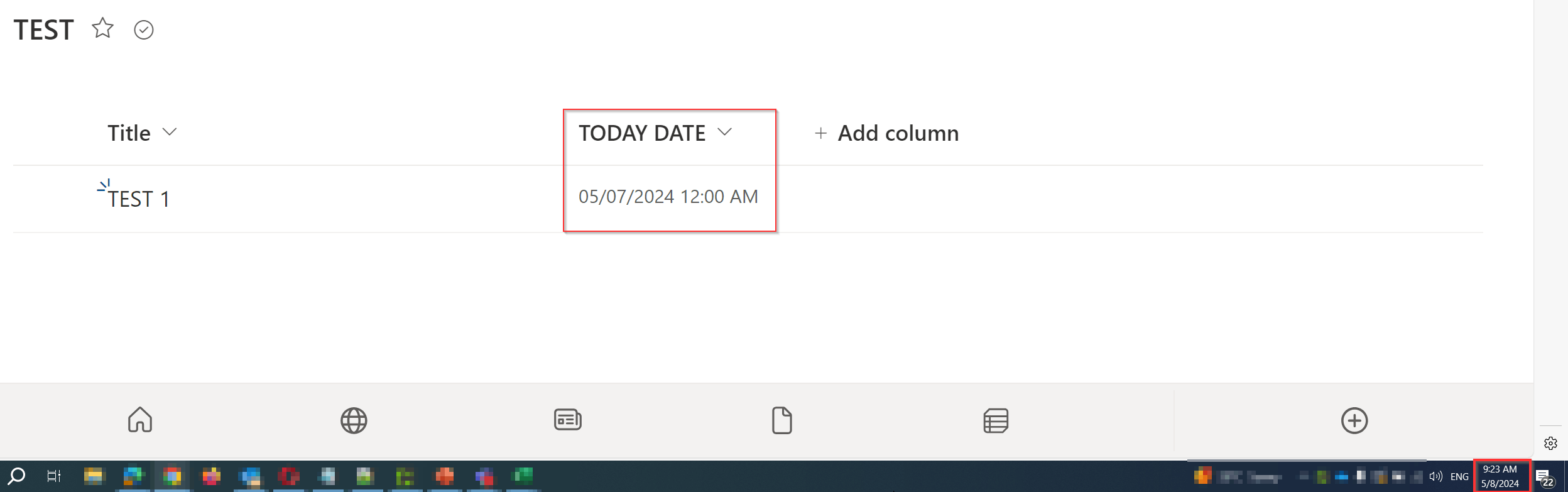

I've encountered an issue with the Today() function in SharePoint list not showing correct date even though time zone already set in Site Regional Settings.

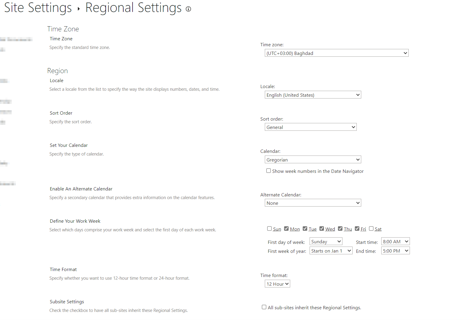

    Hi Sophia,
    Thank you for you quick respond, please see below Regional Settings screenshot.

    2024-05-08T08:55:53+00:00
    Dear Muhanned Shaker,
    Good day!!
    Apologies for the inconvenience caused and please don’t worry, let’s work together on your concern and move towards a resolution path.
    I understand your concern and I would like to convey that I have tested the behavior at my end, where the TODAY() function is working as expected in my test environment.
    Since, you have set the Time Zone in the Site Regional Settings with no success, I would like to request you to share the screenshot of the Regional Settings of your Site, where we can setup the similar environment and share the results with you:
    Open the SharePoint Online site> Settings> Site Information> View all site Settings> Regional Settings> Take a complete screenshot and share it with us.
    In addition, does the problem happens with the specific SharePoint Online site or any SharePoint Online site?
