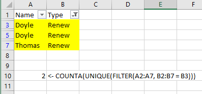

    I'm really sorry, Aleisha. I originally pasted column B into column C for some testing and used the data in column C directly while writing formulas. However, when I was creating screenshots for you, I deleted the data in column C but forgot to update the formula. The correct formula should be:
    =COUNTA(UNIQUE(FILTER(A2:A7, B2:B7 = B3)))
    This means using the FILTER function to select cells in column A that are in the same row as cells in column B with the value "renew." Then, the UNIQUE function is used to remove duplicates, and finally, the COUNTA function counts the number of items.
    Since cell C3 was blank, no matter how the filtering was done, the incorrect formula would always return 1. This was my mistake, and I apologize again.
    Let's verify together if this formula works correctly.
    For example, if I want to filter cells where Type=Renew, theoretically, the yellow cells represent the data filtered out after Type=Renew.
    After applying the filter, we should get the following result:
    The formula should remove a duplicate "Doyle," and the result should return 2.
