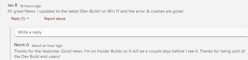

  1. GoldenVenom 26 Reputation points
    2021-11-15T11:09:40.423+00:00
    So, i wanted to roll back to 10 and was like "F* it, just try the Dev channel before the rollback" and.. it's gone for now? I don't know if there will be a crash soon, but the SCEP is gone in Version Dev (Build 22499.1010). I'll rerun the Task "AikCertEnrollTask" in the Task Scheduler which gave me the SCEP error (just for testing purposes) and for now, even with a manual run, the SCEP error is gone.
    I also don't know, if it would be enough to use Beta-Channel instead of Dev. In the patch-notes i can't find any related information wheather it got fixed or its just lucky

  3. Norm Geltz 171 Reputation points
    2021-11-16T21:36:11.3+00:00
    Evidently this issue has been resolved with the latest Dev-Build update (yesterday, Monday, Nov 15, 2021). I run Insider Editions therefore I cannot validate since I'm generally several days behind the Dev-Build OS updates. None-the-less, I wanted to share this information. The individual who posted did not indicate what the Dev-Build number is. Be patient is all I can say.
