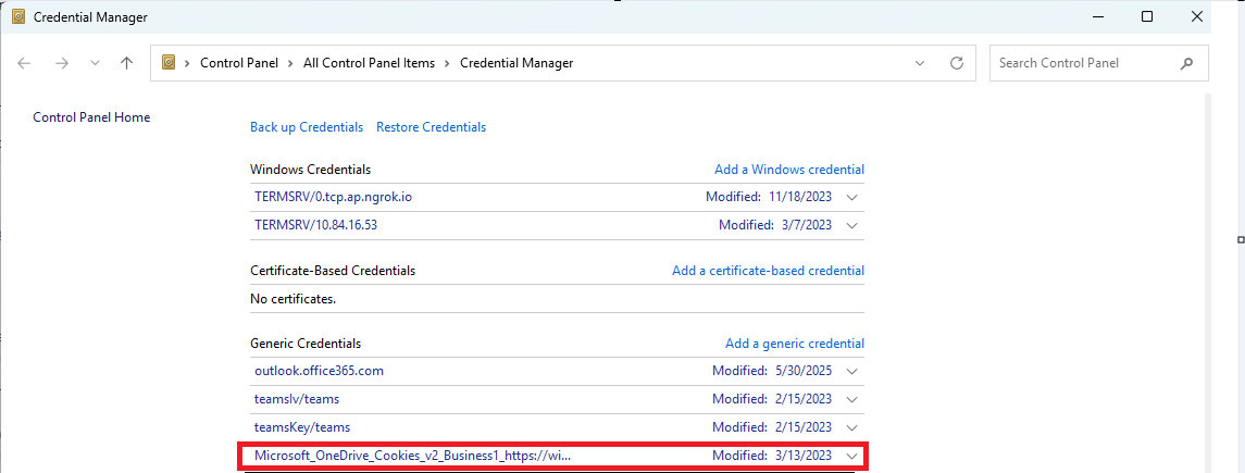

    1. Remove OneDrive cookies:
    • Press Windows + S and type Credential Manager, then select Windows Credentials
    • Choose OneDrive cookies then remove

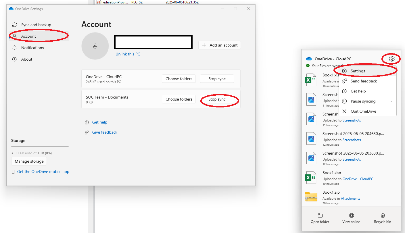

    1. Try to Sync from OneDrive Account
    • Click the OneDrive cloud icon in the system tray.
    • Go to Settings > Account and select Choose folders.
    • Pick the folders you want to sync to your device.

    Appreciate the help! Those first 2 steps (deleting Windows credentials and registry entry) seemed to fix the issue.
