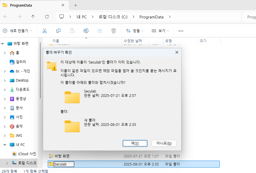

Hello, I'm playing a game from Steam called djmax, and that game have a hack detecting program called xigncode, which is a anti-hack program developed from South Korea. And the program from Seculab is having a problem with that xigncode, making me unable to run the program normally. And if I go to my C Drive, there isn't any folder called Seculab, and the program file don't exist.
And the program that is having an issue is in C:\ProgramData\Seculab\NTFSService\NTFSHookInjX64.dll. But I cannot access to that folder.
Here it says it exists, but when I go to that folder, it says sth like 'cannot access to the folder. check if it exists or spelling mistake, or if it's the folder that is in pc but connected to network, checkout network settings.'
Can anybody please help with this stuff?

    • Step 1: Show Hidden and Protected Files
    Some folders, especially under C:\ProgramData, are hidden or protected by default.
    -Open File Explorer.
    -Click ViewShowHidden items.
    -Then go to OptionsChange folder and search optionsView tab.
    -Uncheck “Hide protected operating system files (Recommended)”.
    -Click Apply and OK, then try accessing the folder again.
