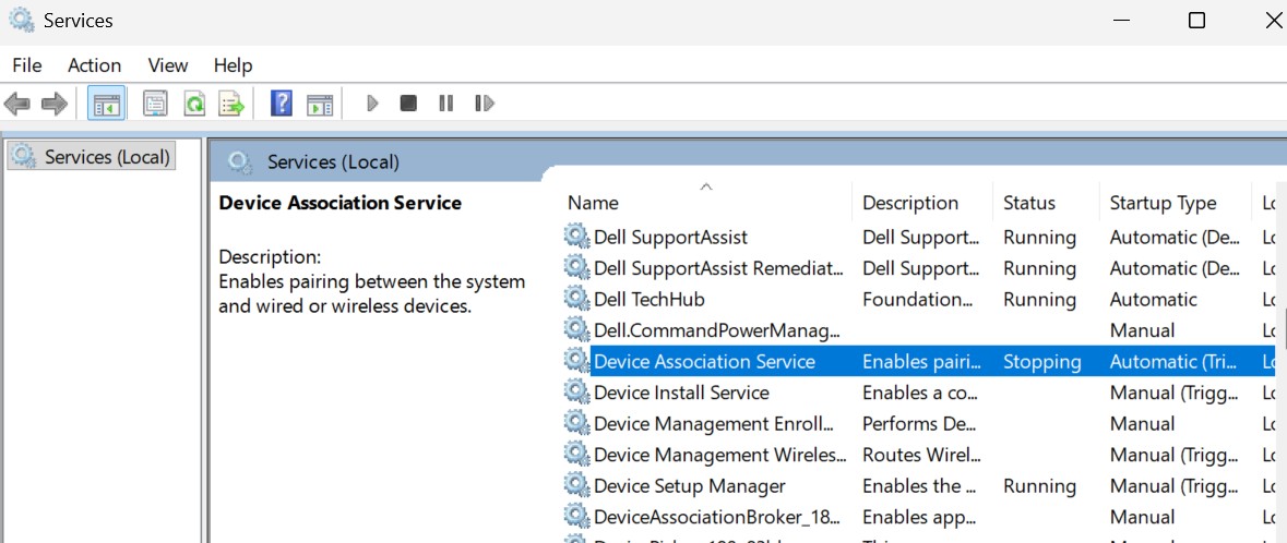

    Hello, if this is the situation, we can try other options -
    1. Click Windows + R key, type services.msc and click ok.
    2. Locate Device Association Service > make sure the service is running and set the startup type to Automatic.
    3. If the service is already running, restart the service.
    If the issue persists, open a PowerShell (Administrator) Window and execute the command below.
    Get-AppxPackage -AllUsers | Foreach {Add-AppxPackage -DisableDevelopmentMode -Register "$($_.InstallLocation)\AppxManifest.xml"}
    This command can help repair the Windows Shell Experience Host by re-registering all built-in Windows apps, including ShellExperienceHost.exe, which I believe is corrupted. This command might take a few minutes, depending on the system performance and apps installed.
    Let me know how it goes.
