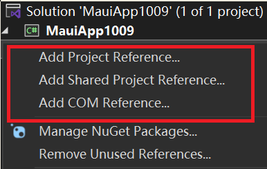

    You can try to follow the steps below to troubleshoot this problem.
    1. Open up your solution in Visual Studio.
    2. In Solution Explorer, right-click the References or Dependencies node, and then choose either Add Project Reference, Add Shared Project Reference, or Add COM Reference from the context menu. User's image
    3. Now the references window will open up - just select the correct DLL with your missing type and hit OK .
