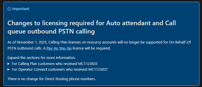

    Furthermore, in Plan for Teams Auto attendants and Call queues – Microsoft Learn:
    Microsoft announced that Calling Plan licenses on resource accounts will no longer support outbound PSTN calls on behalf of Auto Attendants or Call Queues. Instead, a Pay-As-You-Go license will be required for these scenarios. This affects:
    • Outbound PSTN calls made by Auto Attendants or Call Queues.
    • Callback PSTN calls initiated from Call Queues. If these licenses aren’t assigned, outbound calls will fail.
