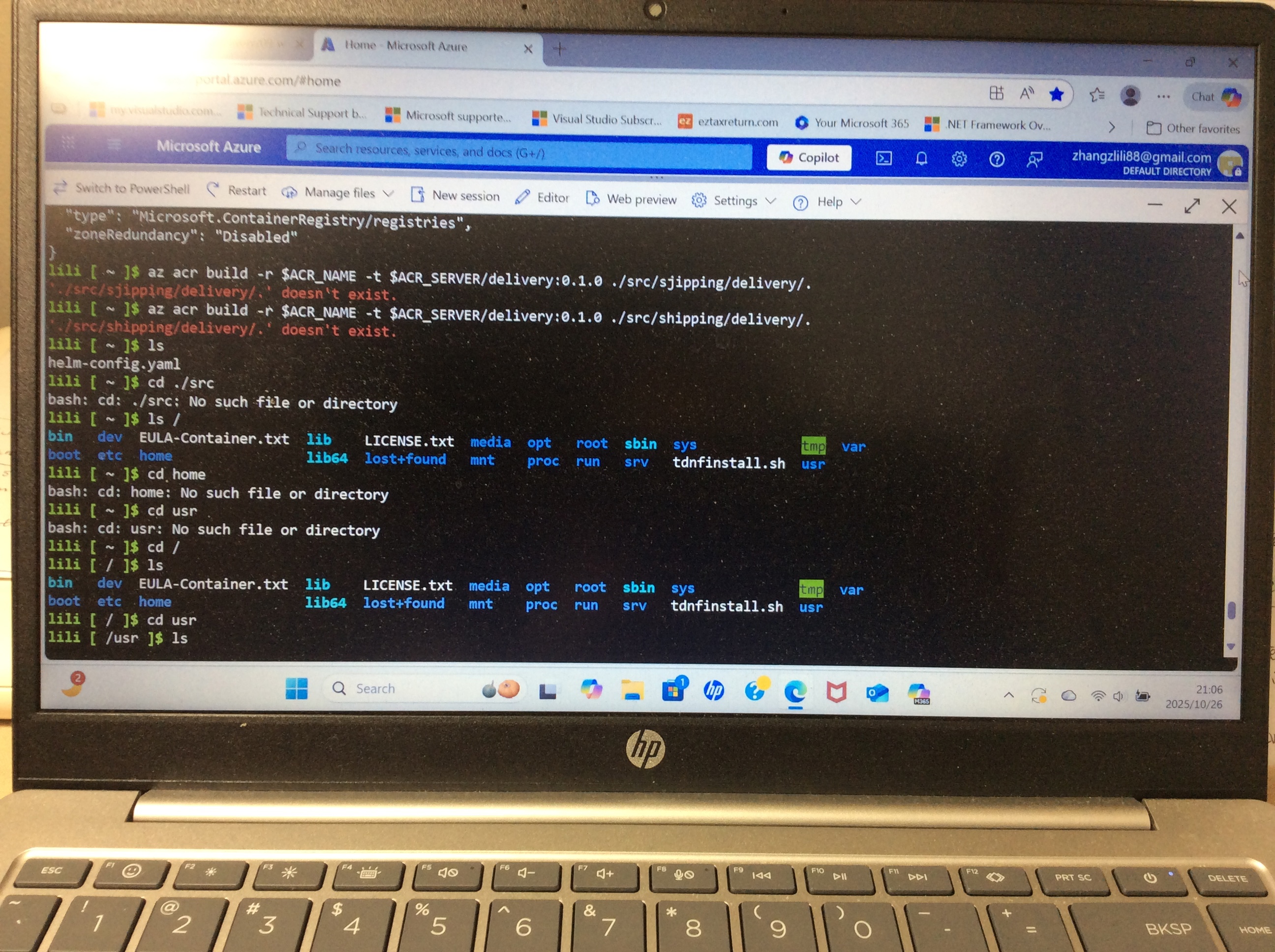

Dear Sir/Madam,
I am testing the reference implementation of "aks-fabrikam-dronedelivery" part9 "workload.md"
and from azurecli did the following:
"az acr build -r $ACR_NAME -t $ACR_SERVER/delivery:0.1.0 ./src/shipping/delivery/."
then got the error message saying "./src/shipping/delivery/. does not exist" shown as the picture.
Please advise me on how to get this path of "./src/shipping/delivery/." az_acr_build_error.JPG ?
Thanks,
Lili

    The error means that the path ./src/shipping/delivery/. does not exist in your current directory. Based on the command, you should expect this folder structure:- src->shipping->delivery->Dockerfile
    Can you do a quick check if the folder actually exists?
    1. Check if there's any directory named shipping or delivery:
    # Check your current location
    pwd
    # List the directory structure
    ls -la
    # Check if the shipping directory exists
    find . -name "shipping" -type d
    1. If you can find the folder exists and the Dockerfile exists as expected but still the error throws up maybe you could try below formats of the command as well to see if it works out.
    # If you're in the root of the repository, try:
    # Or if you're in a different location, navigate to the root first, then try below command:
    # Relative path without trailing dot
    az acr build -r $ACR_NAME -t $ACR_SERVER/delivery:0.1.0 src/shipping/delivery
    # Or use absolute path
    az acr build -r $ACR_NAME -t $ACR_SERVER/delivery:0.1.0 $(pwd)/src/shipping/delivery
    1. Worst case, you can try creating the file manually and see if the command works out for you.
    git clone <repo-link.git>
    Additionally, I've asked few subscription related details in the Private Message, kindly check and answer them so that I can assist you better way.

    The message "./src/shipping/delivery/. does not exist" means the Azure CLI can't locate the build context path when pushing your Dockerfile and source to ACR. In az acr build, the final argument specifies the local directory to use as the build root (containing the Dockerfile and app files)—it resolves relative to your current shell location. If you're running the command from the repo's root (e.g., /path/to/aks-fabrikam-dronedelivery), ./src/shipping/delivery/. should point to the delivery service's folder, but the trailing "." might confuse the parser or indicate a deeper issue like:
    • Wrong Directory: You're not in the cloned repo root, so ./src/... 404s.
    • Incomplete Clone: Git didn't pull all submodules or files (the repo has multiple services like shipping/delivery).
    • Path Syntax: The trailing "." is valid (it includes the current dir), but if the folder lacks a Dockerfile, ACR skips with this error.
    • Permissions/Environment: Running in a restricted shell (e.g., Azure Cloud Shell without mounted storage) or with case-sensitive path mismatches on Linux.
    From recent GitHub issues on the AKS samples repo (updated September 2025), this pops up if the git clone missed branches or if users skip the cd into the project folder. It's not an ACR bug but a local setup hiccup—ACR itself is healthy per Azure Status.
