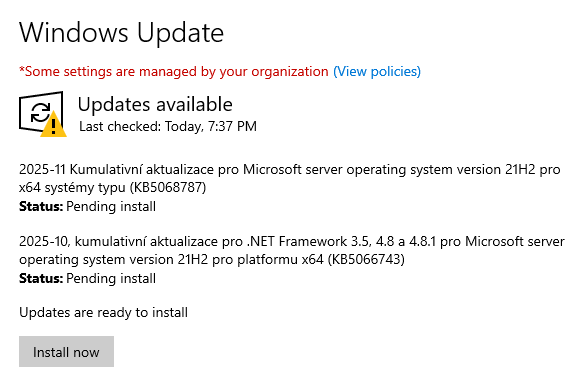

I have problem with the pwsh script on Windows Server 2022. It declares that updates were installed but doesn't make restart and the list of updates from GUI / Settings / Updates is not empty.
The core calls
Get-WindowsUpdate -MicrosoftUpdate -AcceptAll |
    Install-WindowsUpdate -AcceptAll -AutoReboot -Verbose 4

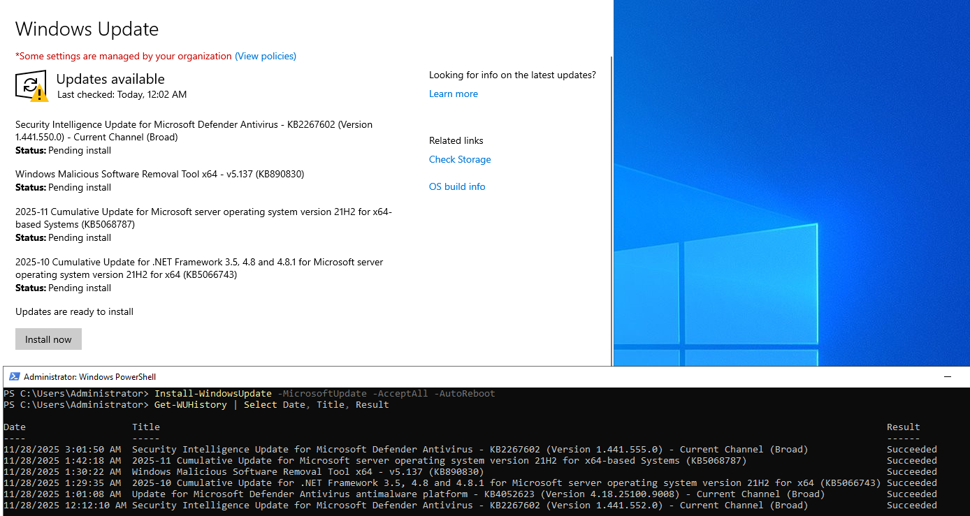

  2. Jan Vávra 466 Reputation points
    2025-11-21T09:17:08.8966667+00:00

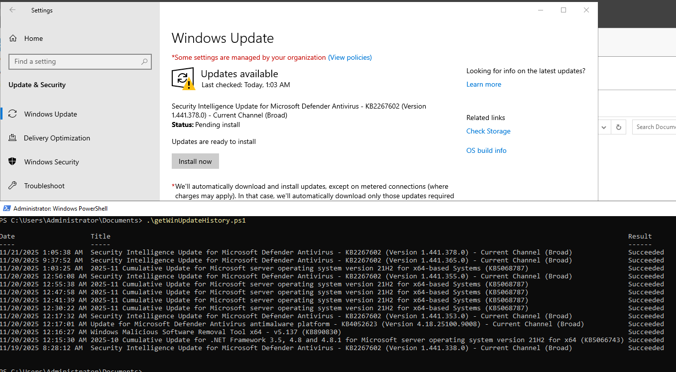

    I took another versions of Windows, eg. Windows Server 2022 from Sep 2025 Datatacenter.
    The Windows update page declares there is a pending install even I ran my script.
    obrazek
    If I run
    Get-WUHistory | Select Date, Title, Result
    I can see that pending install "B2267602 (Version 1.441.378.0)" was installed.

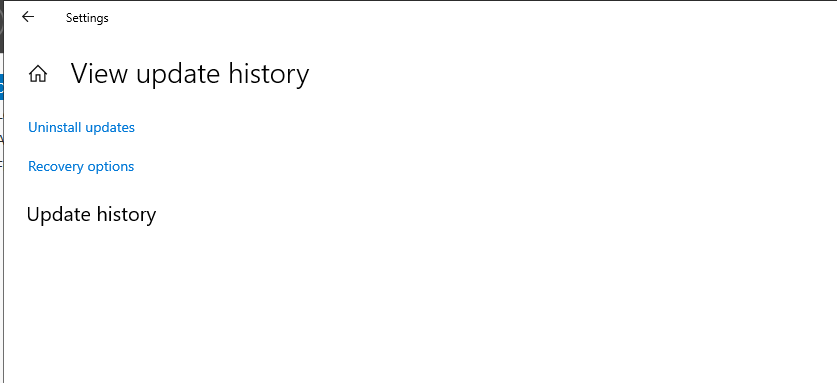

    And also I cannot see anything at View update history page.obrazek
    I think that Install-WindowsUpdate doesn't do all the work ...
    $updates = Get-WindowsUpdate -MicrosoftUpdate -AcceptAll -ErrorAction SilentlyContinue
    $updates | Install-WindowsUpdate -AcceptAll -AutoReboot -Verbose 4>&1
