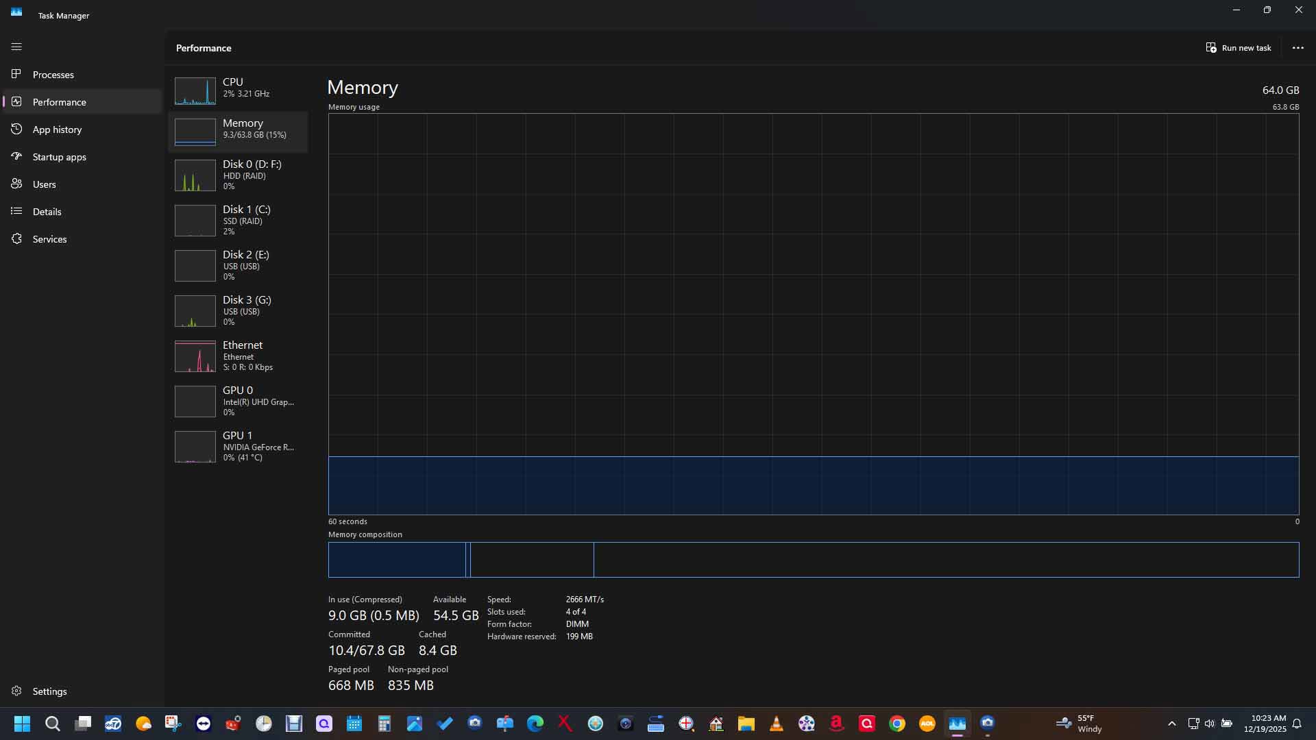

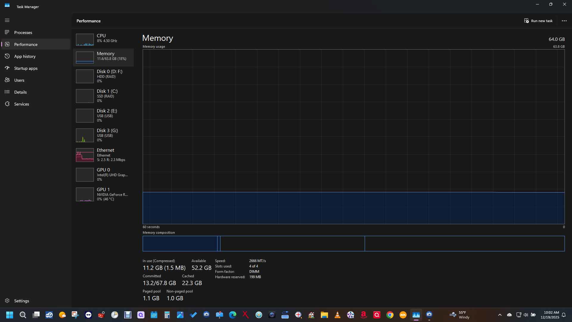

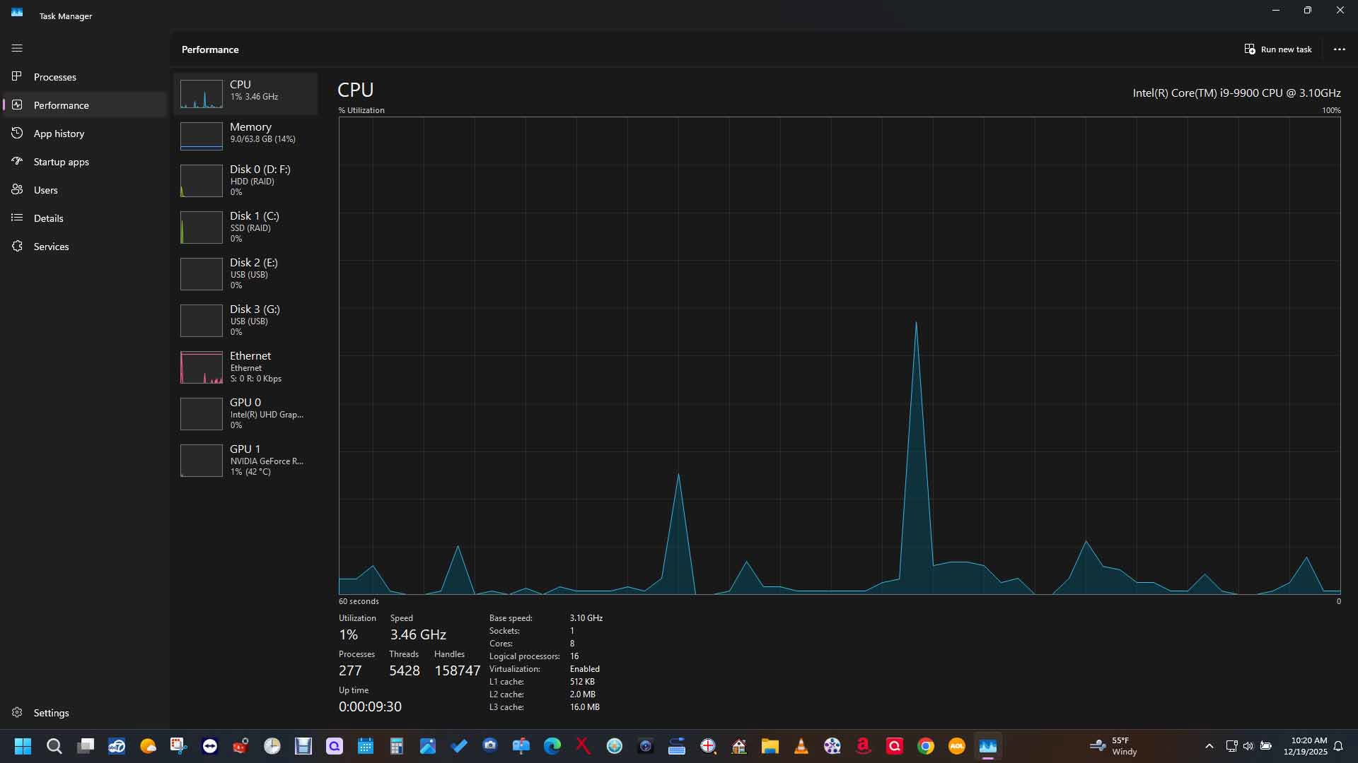

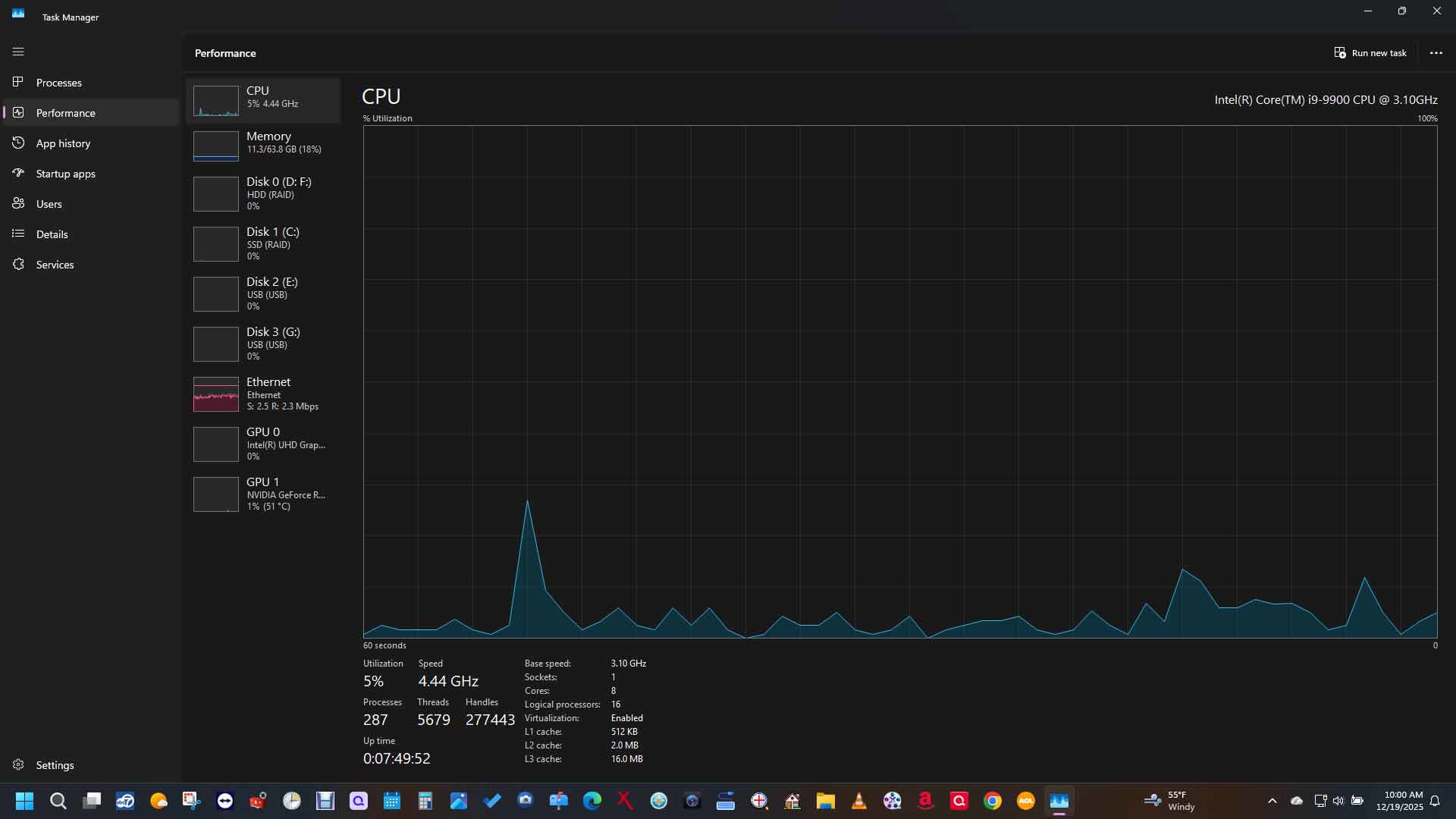

  4. Chris Byrd 50 Reputation points
    2025-12-19T16:03:18.5666667+00:00
    Sorry, I was gathering the rest of the data that you requested and wanted to get a full picture for you on the CPU and the Memory. I did several pulls, and the very first one is after a reboot without the tasks being re-enabled that keep getting disabled. I then enabled everything, and OneDrive was not loading, so I loaded it as well. The last cpu and memory are after a reboot and after the tasks are enabled. OneDrive was reactivated after it was removed again during the reboot. Interestingly, I found a setting that was disabled on the OneDrive, and I thought that would allow it to be loaded again during a reboot. After I pulled the cpu and memory in between, I did a shutdown of the PC, and the PC didn't complete the shutdown, so I had to hold the power button to get it to turn off, and then turned it back on and enabled all the disabled tasks, and had to reload the OneDrive again because it still didn't automatically reload.. I wanted to explain the pictures before I sent them in the order of the time I saved in each picture, along with a brief timeline.
    2:23 AM I got up and the curser was spinning as it always does now so I held the power button to turn the Power off the turned the power button back on. I took the first readings of the CPU and the Memory without enabling the disabled tasks and without restarting OneDrive. Then I realized I didn't change any of the settings before I took the screenshots so before I took the next reading, I enabled all the stuff listed above first.
    8:21 AM I took the screenshot with everything enabled, just like I would normally run my system if it booted up properly. I didn't restart because this was looking for changes in the initial setup but because I made changes to the initial setting by setting it to enable tasks and adding OneDrive back.
    10:02 AM I took another screenshot of the CPU and Memory to see if anything changed. Still no reboot
    10:25 AM I did the shutdown that didn't shut down the PC, so I had to hold the power button till the power went off and turn the power back on. (Even using the shutdown from the Windows Key will not complete the shutdown process. Only pushing and holding the power turns the PC off so that I can turn it back on to boot back up.)
    So I will post this and post the screenshots, and then follow up with the new tasks for gathering information to assist.
