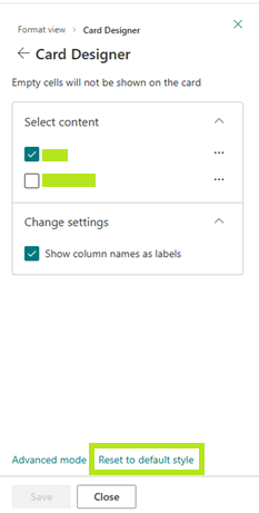

    2/ Temporarily disable Card Designer or JSON formatting
    Custom formatting (such as conditional colors, hiding/showing fields, or reordering fields) can interfere with Board view rendering.
    • Open the list.
    • Click View options → Format current view.
    • User's image
    • Choose Edit card > Reset to default style.
    • User's image
    • Save the changes.
    • Refresh the Board view to check if cards render.
    • If successful, you can reapply formatting later once the issue is resolved.
