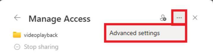

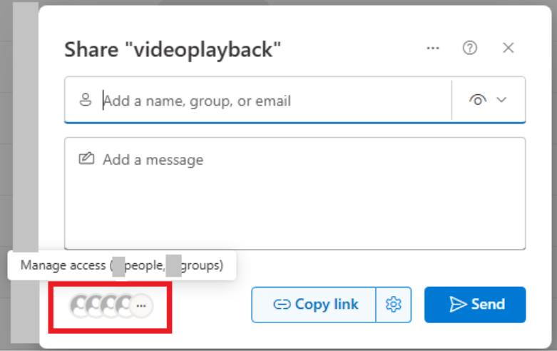

    Click Shared > Manage access.
    Choose Advanced settings.

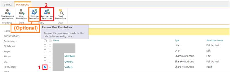

    Remove the external group (“Your site name Visitors”).
    This approach ensures external users cannot view, open or access internal material.

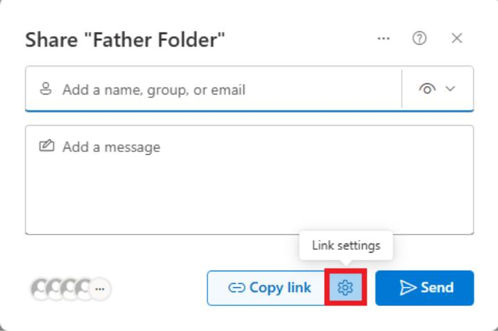

    In SharePoint or OneDrive, select a file or folder.
    Click Shared.

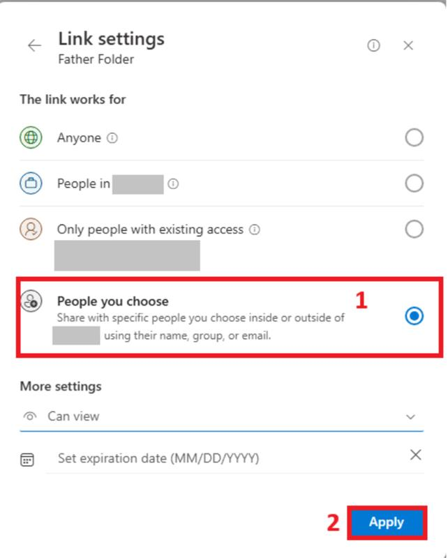

    Select Link settings and choose “People you choose” (Specific people).
    Enter the email addresses of your external recipients.
    Set permissions:
    Can view or can edit, depending on what you need.
    Send the link. Recipients will verify their identity before accessing.
    This method keeps your organization very secure while still enabling controlled collaboration.
