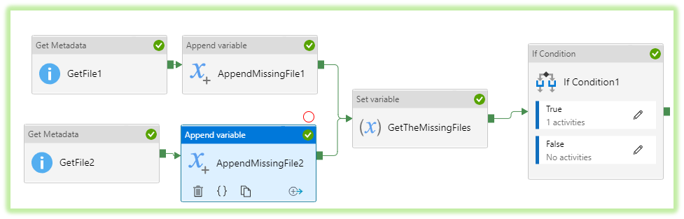

    Alternative
    The other approach I thought of is below
    For every non existing File, the filename is appended to an array variable - MissingFiles.
    The below is the expression for AppendMissingFile1.
    @if(activity('GetFile1').output.exists,'','File1')
    You will repeat the process for all the five files.
    Note: You will be appending empty strings ''when doing the above action to the array.
    So, you will have to eliminate the same. That is being taken care the in the GettheMissingFiles (Set the Variable activity) - MissingFileswithoutBlank
    @intersection(createArray('File1','File2'),variables('MissingFiles'))
    The output of this action will contain the name of all missing files in an Array variable (MissingFileswithoutBlank)
    Like the above explained step, you can get the length of the collection (MissingFileswithoutBlank) - if it is 0 - you can proceed with the necessary activities, if not you can do the failure activities in the false activities.
    **On Failure - when files are missing **
    You can execute the below activity false section of last the IF condition (If condition 3 & 1 ) in above screenshots.
